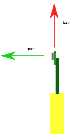

The 10 cm accuracy is if everything is setup right and the antenna are all pointing directly to the crazyflie like this:
Screenshot from 2020-12-21 11-32-44.png (5.87 KiB) Viewed 5912 times
So in practice I wouldn't be super surprised of an accuracy that is 15-20 cm off, However, if this is with the flowdeck attached, I would agree that it should be much better. Have you tried with the flowdeck alone? It has a tendencies to under or overestimate the flow, especially when there is no or little texture on the ground.
