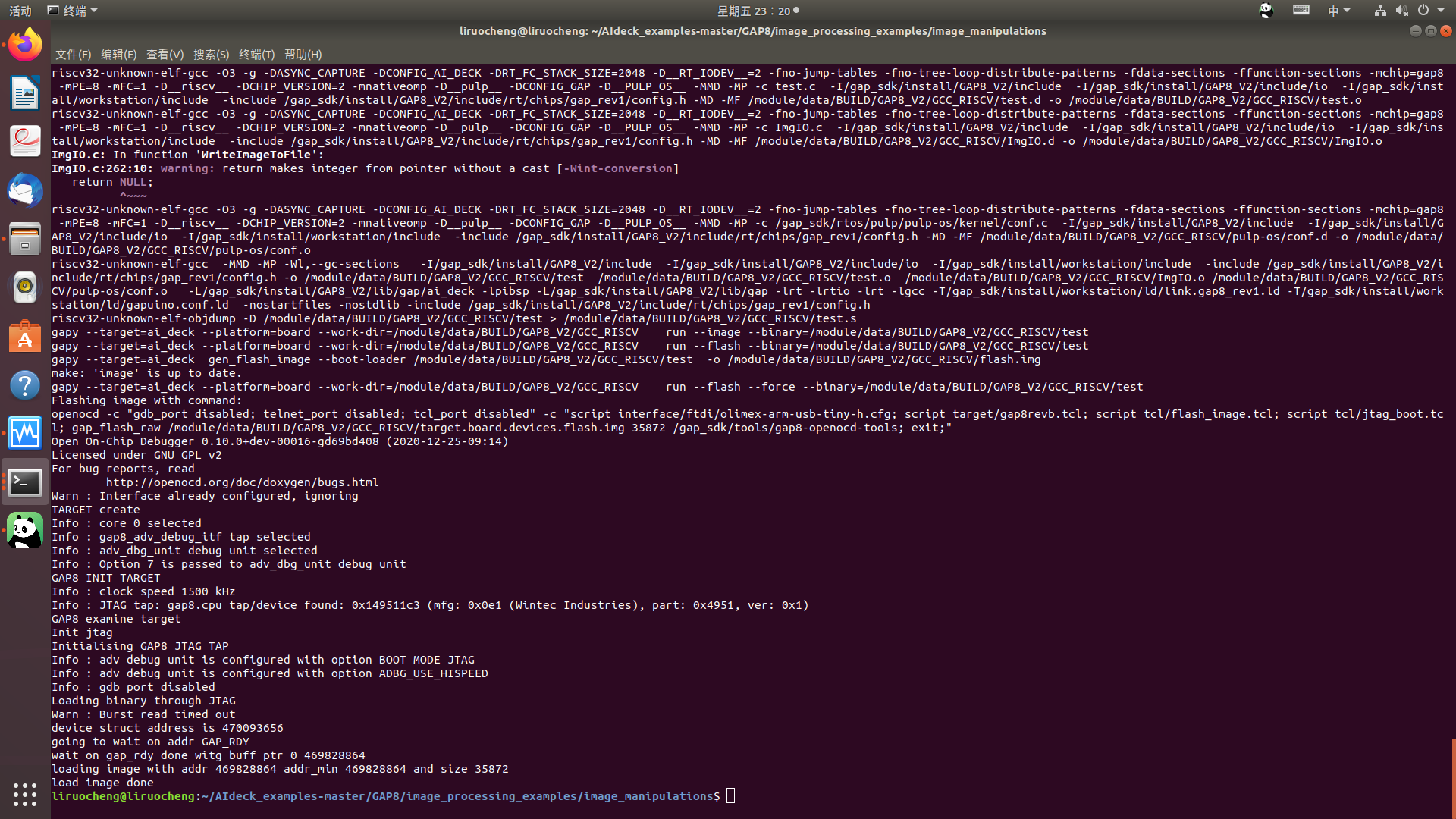

I have already flashed the NINA and I can receive the "Bitcraze-AI deck example";
I use this command to make sure whether AI_deck works;
docker run --rm -it -v $PWD:/module/data/ --device /dev/ttyUSB0 --privileged -P gapsdk:${GAP_SDK_VERSION} /bin/bash -c 'export GAPY_OPENOCD_CABLE=interface/ftdi/olimex-arm-usb-tiny-h.cfg; source /gap_sdk/configs/ai_deck.sh; cd /module/data/;  make clean all image flash'
However, when I run python3 viewer.py, there is no image and always mentioned "connecting" ,but "socket connnected"
I have no idea to solve this problem,so what's wrong.....
							Always mentioned "connecting" when using viewer.py

Currently you are trying to flash the test program image manipulations which does not do anything with streaming the images so it is logical if you dont see anything. Please use the wifi_jpeg_streamer example instead. Cd to that folder and run the docker command again. The LED of the GAP8 should be flashing after restart.
By the way, if you replace the last command in the docker command to:
this will perform an on RAM execution of the code. Then you can also see all the readouts and you would be able to debug if anything hangs.
make clean all runRe: Always mentioned "connecting" when using viewer.py

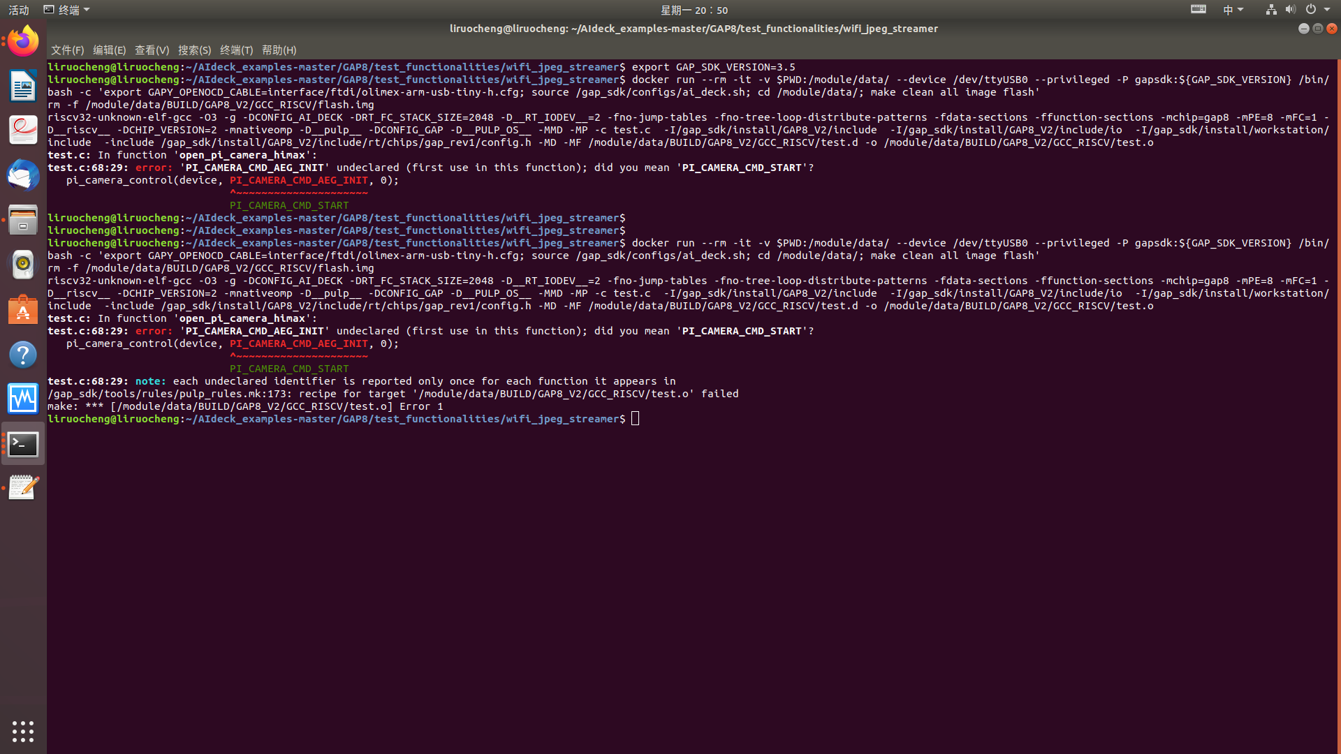

Yes, I have done this , but there is an error....
It reminds me this....
I see that you are currently using GAP_SDK_VERSION  number 3.5, however, the github repo has been updated to work on SDK version 3.8 since  this ticket. If you just want to check if things work, you can quickly revert to before these changes.
However, I would very much advise to update your docker to 3.8.1 by following the instructions again with the new dockerfile.
