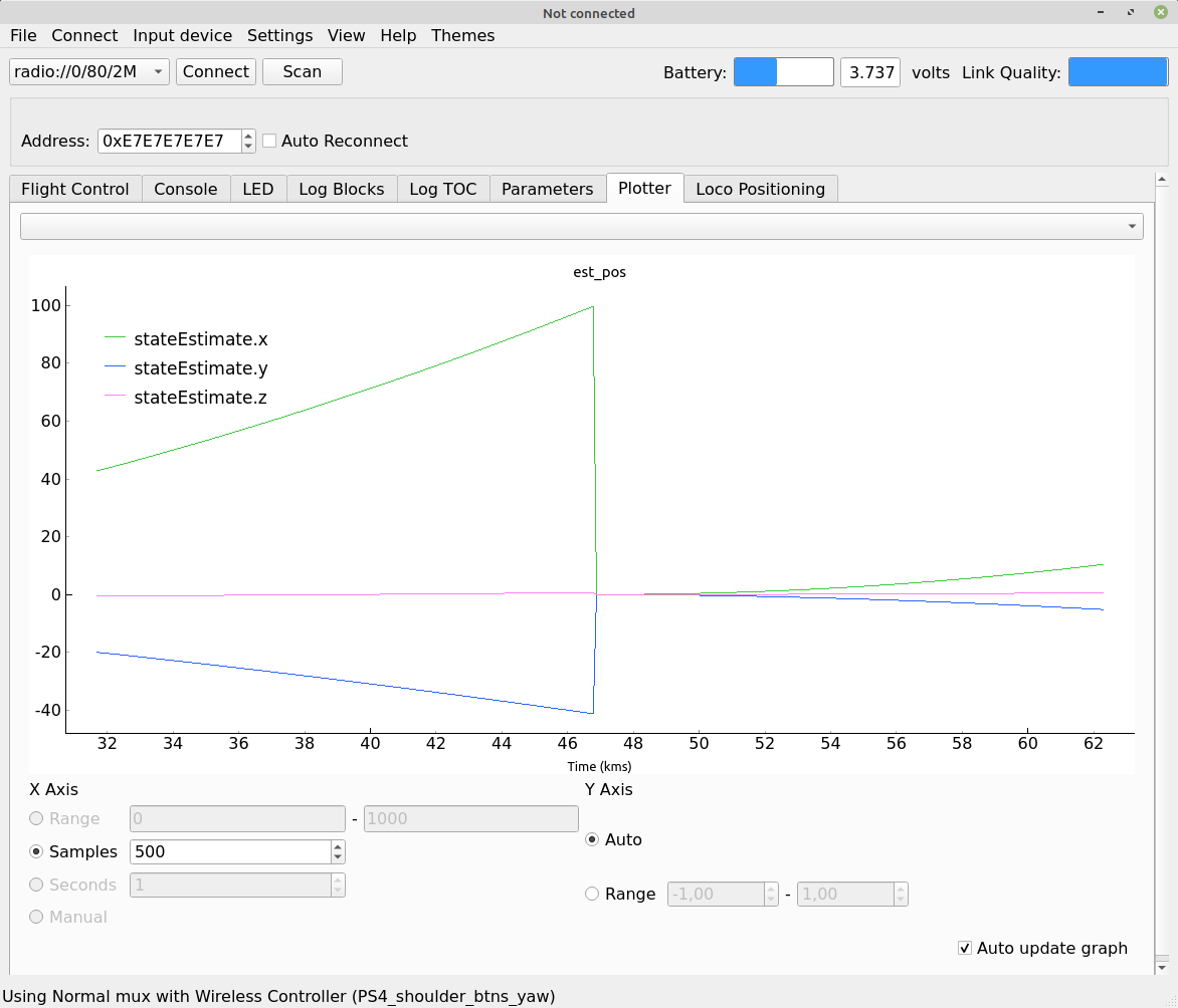

I have the same "position estimate divergence" problem. I'm using two V1 base stations and followed the LH setup instructions, including pasting the results of the get_bs_geometry.py script into the lighhouse_core.c source file, building and flashing. The CF seems to boot without errors and even receives V1 base station calibration data (see console output below). When I display lighthouse angles via the cfclient logging/plotting function, the angles seem plausible and also react to position changes of the CF (see screenshots). However, the position estimate diverges quickly until being reset by the KF monitor.

cfclient plot of divergent lh position estimate
cfclient plot of lighthouse angles when moving the CF
