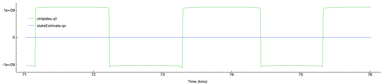

I am relatively new to coding in C, and I am trying to add a custom controller to the crazyflie firmware. I wanted to do some troubleshooting to make sure that the controller was receiving the correct state, and so I decided to log the state information in stabilizer.c after it was passed to the controller. From what I understand, the address of the state information is passed to the controller function in the main stabilizer loop here:
controller(&control, &setpoint, &sensorData, &state, tick);Then, the controllers use the information as necessary. However, when logging the output of the state information directly from the controller script, the values seem to change drastically. I tried logging some state information from controller_pid.c and controller_mellinger.c to see if I made a mistake, but they were outputting the same conflated values. The controllers are all working fine, so I assume that I am somehow accessing the variables incorrectly when logging. I should note that the same state values are all outputted properly in the stateEstimate log block in stabilizer.c.
This picture shows the output of q1 (quanterion) from the the stateEstimate log group as I rotate the crazyflie, and it looks as expected: This picture shows the output of q1 from the log group in controller_pid.c as a I rotate the crazyflie. If you notice the y axis, the values have become huge, on the order of 10^9. Also, its hard to see in the picture, but if you look really closely, you can see that the value is changing as I rotate the crazyflie. It also jumps around +/- 10^9. This all leads me to believe that I am accessing the correct variable, but I am somehow scaling/changing it from what is originally in the state variable.
The following is my attempt at logging the state variables in controller_pid.c

LOG_GROUP_START(ctrlpidex)
LOG_ADD(PARAM_FLOAT,q1, &statet.attitude.roll)
LOG_ADD(PARAM_FLOAT,q2, &check)//state_full[4])
LOG_ADD(PARAM_FLOAT,q3, &check)
LOG_ADD(PARAM_FLOAT,q4, &check)
LOG_GROUP_STOP(ctrlpidex)
