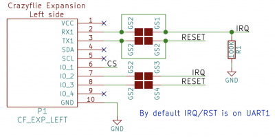

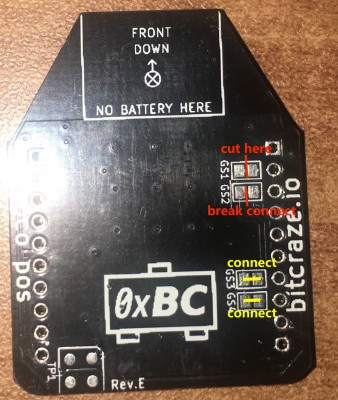

Indeed, it would need a software update in order to make it to work. As you can see in the wiki link I've send to you, the UART1 port is the one that is conflicting with the LPSdeck (bcUWB).
