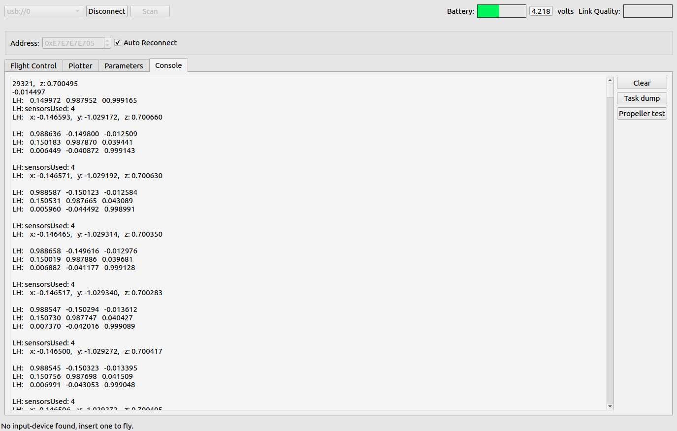

I am finally testing the algorithm coded in the crazyflie firmware using the console (I attach a console output example of the code I added when de drone is in my flat table facing X axis, where the rotation matrix is near to identity). It works apparently, but I am not being able to feed the EKF with the pose data. I am not sure why, but "estimatorEnqueuePose" function is not working for me. I know it because when I plot the StateEstimate in cfclient it does not converge (attached image of this), while using "estimatorEnqueuePosition" it works. After some tests I tried to feed the EKF with a simple fixed pose:arnaud wrote: ↑Thu Aug 15, 2019 9:15 am Hi,

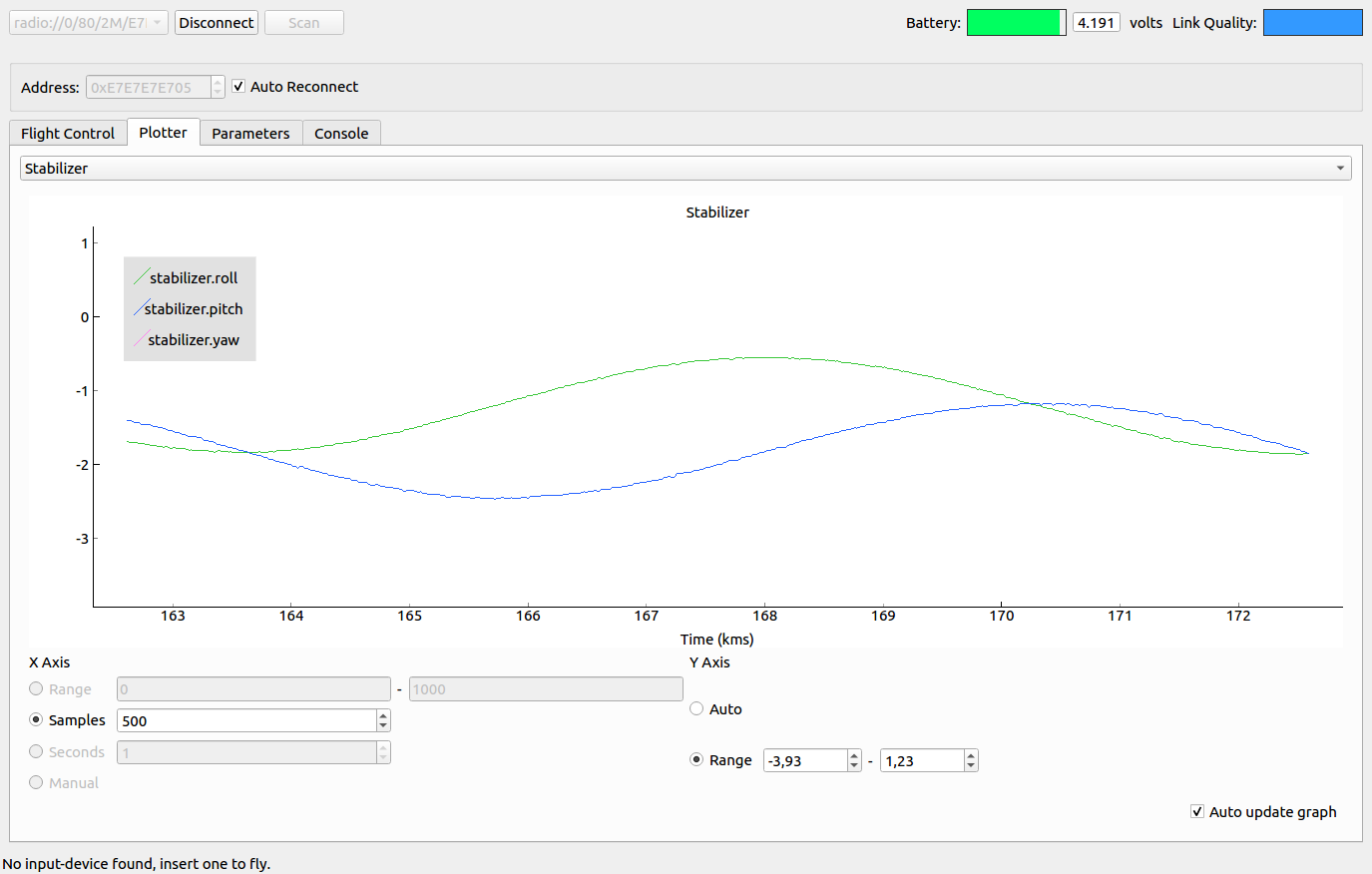

I attach a picture of the fluctuations in the roll/pitch angles using kalmanUSC being feed with the new LH rotation data, having the drone resting. I do not know what is the reason behind of this oscilations. Any case, I wanted to use the default Kalman estimator, since is the estimator I was using in my experiments lastly. I tried to study a little bit the Mueller paper to be able to integrate the rotation data in the EKF, but then i found the SO3 formulation and error attitude parameters in the state vector. I am not familiarized with SO3 and this kind of formulation, then I am going to need more time to get an observation model in order to integrate the rotation data in your EKF with this state vector.
For now, I created a enqueuePose for the default kalman, that integrates position exactly how you do and overwrittes the orientation quaternion. I know this is not optimal, and probabilistics is going to hate me
, but I have a better orientation than only using IMU for the experiments I need now.
