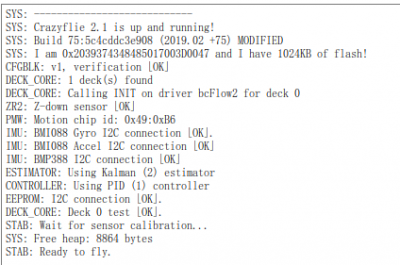

here is my new modification. I add an log "check!!!" just outside the if condition, but I still got nothing to show in the cfclient.

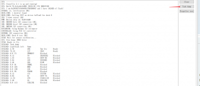

but when I hit the "task dump" button, I got a task list in the console window, which means that the link between crazyflie and my pc functions well.
So any further test I can do to figure out the problem ? thanks a lot ~
