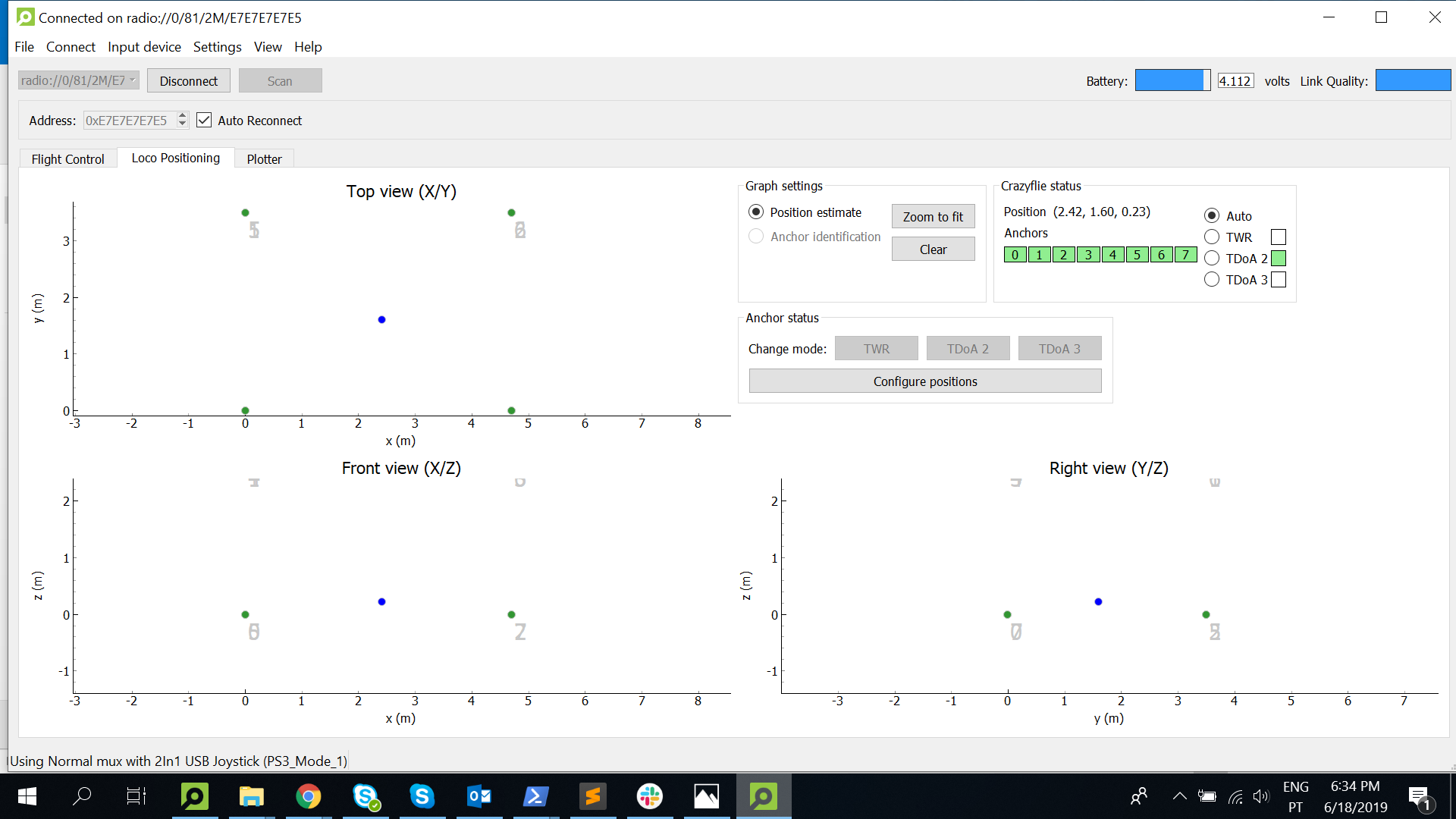

1- I tested with cfclient to verify the position (its correct) - i made the verification for each drone

Are you sure you are in TDoA2 mode and not in TWR?

1 - I confirm that i am using TDoa2
