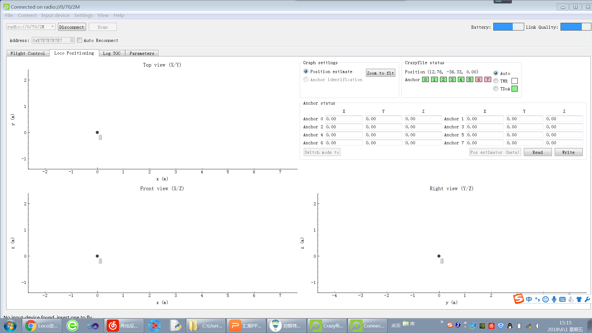

hi, arnaud,
I meet with a similar problem to Alex's.
1) I am using 6 nodes.
2) The firmware of them as well as the drone is up to date and they are indexed 0-5.The cfclient is the latest.
3) All the six anchors,from 0 to 5, in the crazyflie status tab, are green.
4) But the anchor position fields stay white no matter what I do. They never turn red or green.
It turns out like this
Hope you can give me some suggestions,thanks!
Posts: 2070
Re: Loco Positioning System Setup
Post by arnaud » Mon Jun 04, 2018 10:45 am
Thanks for the detailed description :).
Have you tried to program the anchor position anyway with the write button? If there is no anchor position at all in the anchor it is possible that the fields stays white.
