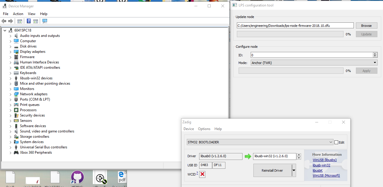

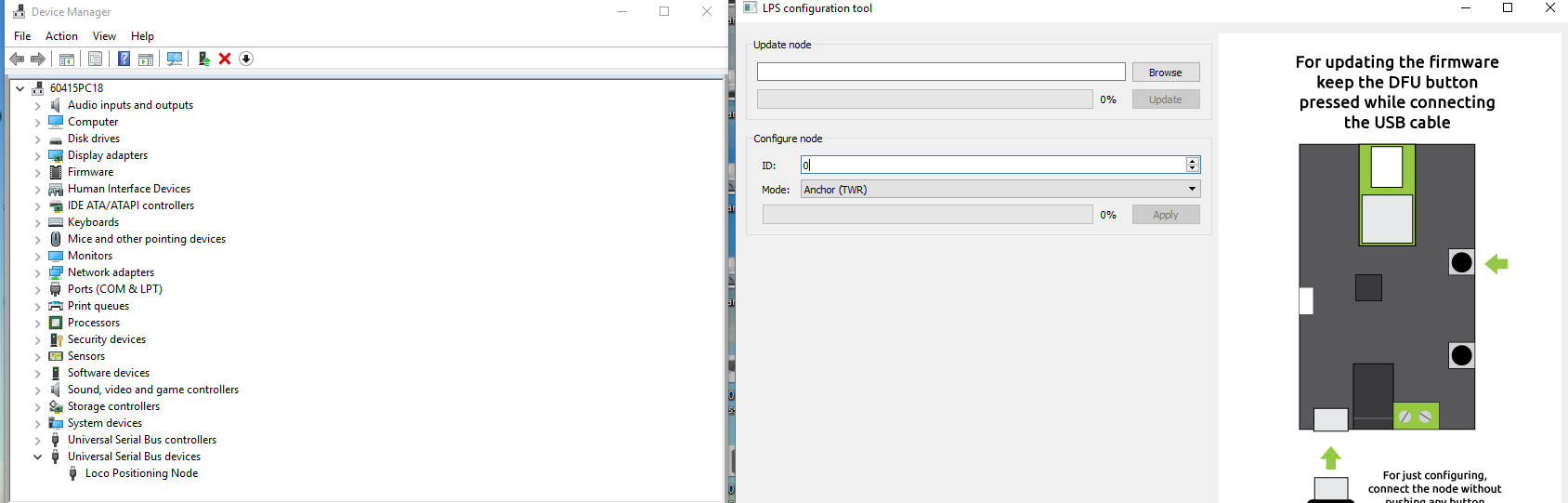

I have spent many hours trying to update the LOC nodes. I am using Windows 10 and I am running the virtual machine. I turn off the virtual machine and I press the top button on the LOC. The board blinks blue. My device mange shows STM32 Bootloader ( sometimes I have to run zadig and replace STM32 Bootloader). I browse and select the firmware lps-node-firmware-2018.10.dfu. However, the update button remains greyed out.
If I just plug the LOC node into the computer, My Device manager shows Loco Positioning Node
However, I am unable to configure the node.
I tried this on my laptop running windows 10 and I am having no luck there as well. I have attached a document with screen shots.

In your screenshot, the loco node appears as a libusbk device, it should not. And the bootloader does not appear to be libusbK or libusb-32, which it should.
One way that should solve the problem is to connect the node while pressing the DFU button and then in zadig install the libusb32 or libusbK driver for it. It should then be recognized by the lps-tools.
When the node has restarted in firmware mode, in zadig, you can replace the libusbk driver by the usbser driver, or you can uninstall the usbk driver from the node. There should not be any specific driver needed for the node in firmware most, it is seen by Windows as a USB serial port.

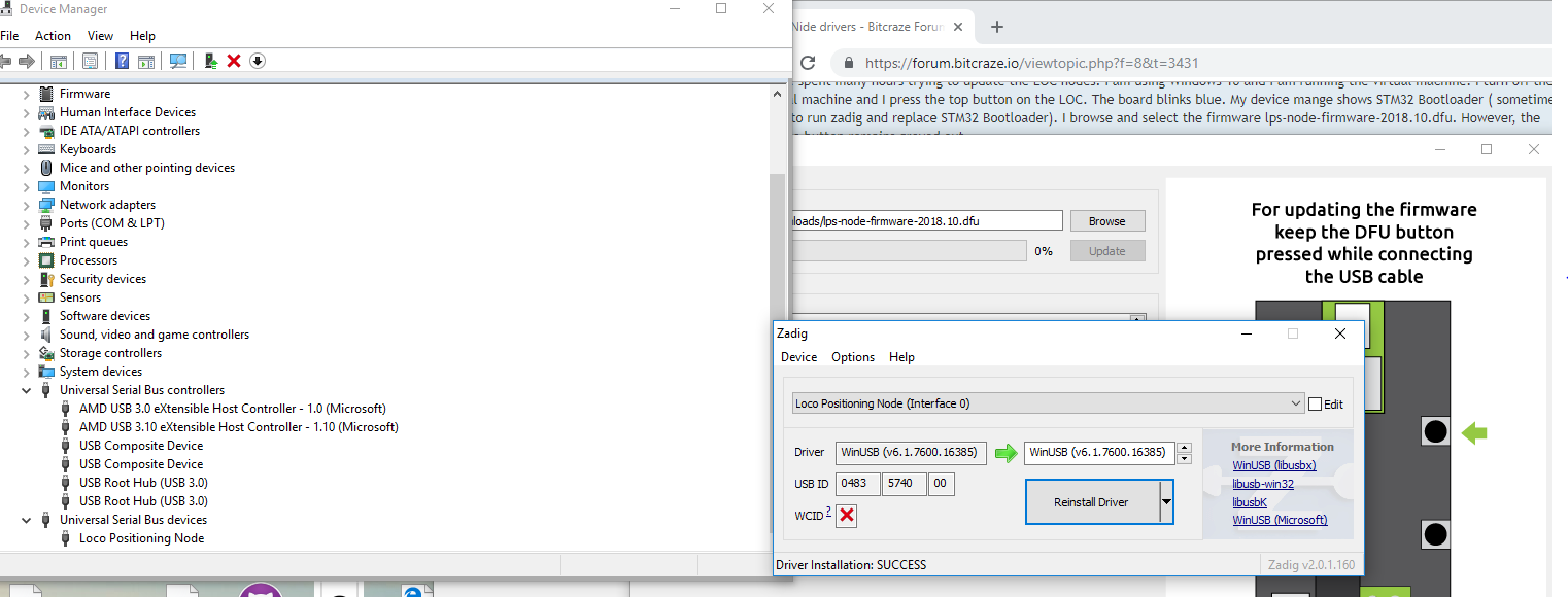

When resetting the node in firmware mode you should not have WinUSB: the node implements an USB serial port and the lps-tools is looking for this serial port to show up.
You can either re-install the serial port driver with zadig, it should be called "usbser". You can also just uninstall the driver from the device in the device manager and after disconnecting and reconnecting the node it should appear as a serial port.

Here is a screen shot of the device manager and LPS tool. I have already updated the firmware.
