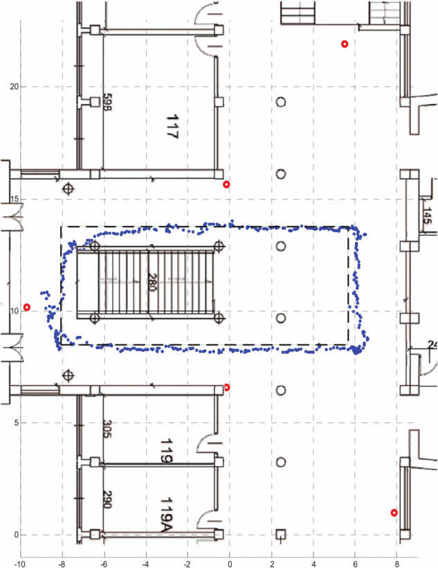

I found reference to an article in the blog where researchers used LPS system in area of approx 7x14m divided into 4 rooms, using only 6 anchors.

There are many ifs and buts when it comes to the number of anchors. If you run TWR mode like in the article you are referring two, 6 anchors will get you pretty far but then you are limited to one Crazyflie (or possibly more if you run TWR-TDMA). If you run TDoA (basically unlimited amount of crazyflies) we recommend at least 8 anchors, but now accuracy is more sensitive in regard to how you place your anchors.
