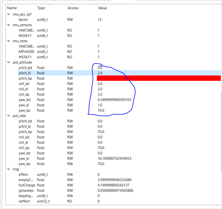

[2] what is the difference between putting all of the attitude pid values to 0 and hard coding the CF into Rate mode?
don't both methods stop the attitude loop of the pid from doing anything?
[3] when I am PID tuning the CF on a string, do any of these setting need to change? like max angle and slew limit? (see picture attached.)

[1] Yes rate and attitude mode still exist however it is now put in a setpoint struct and this is done in crtp_commander_rpyt.c. Maybe you can tell us a bit more what you want to achieve, will be easier to help out then.
[2] If you set all PID gains to 0 you will get 0 as output which is probably not what you want. If you set P gain to 1 you will get the error as output which is not what you want either. I don't know if it's possible to do without bypassing the attitude PID.
[3] When tuning it you don't have to change anything else other then the PID gains.

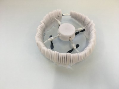

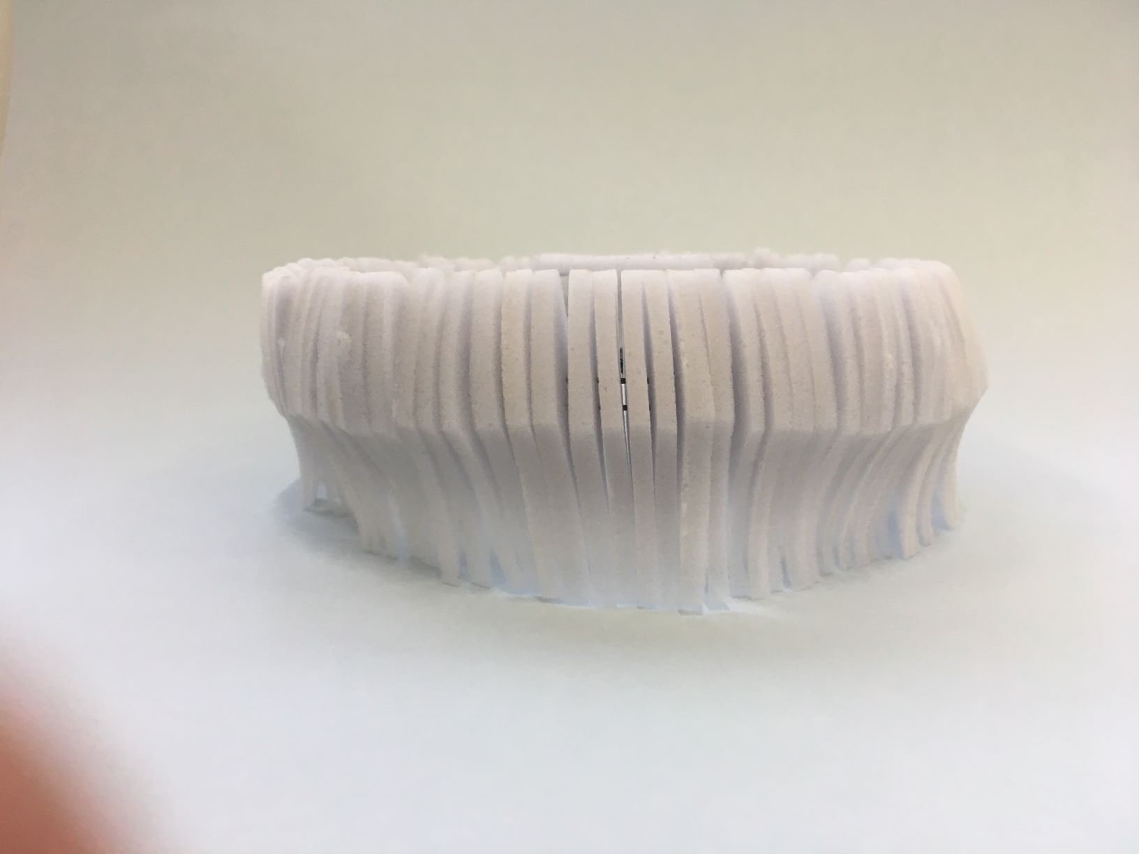

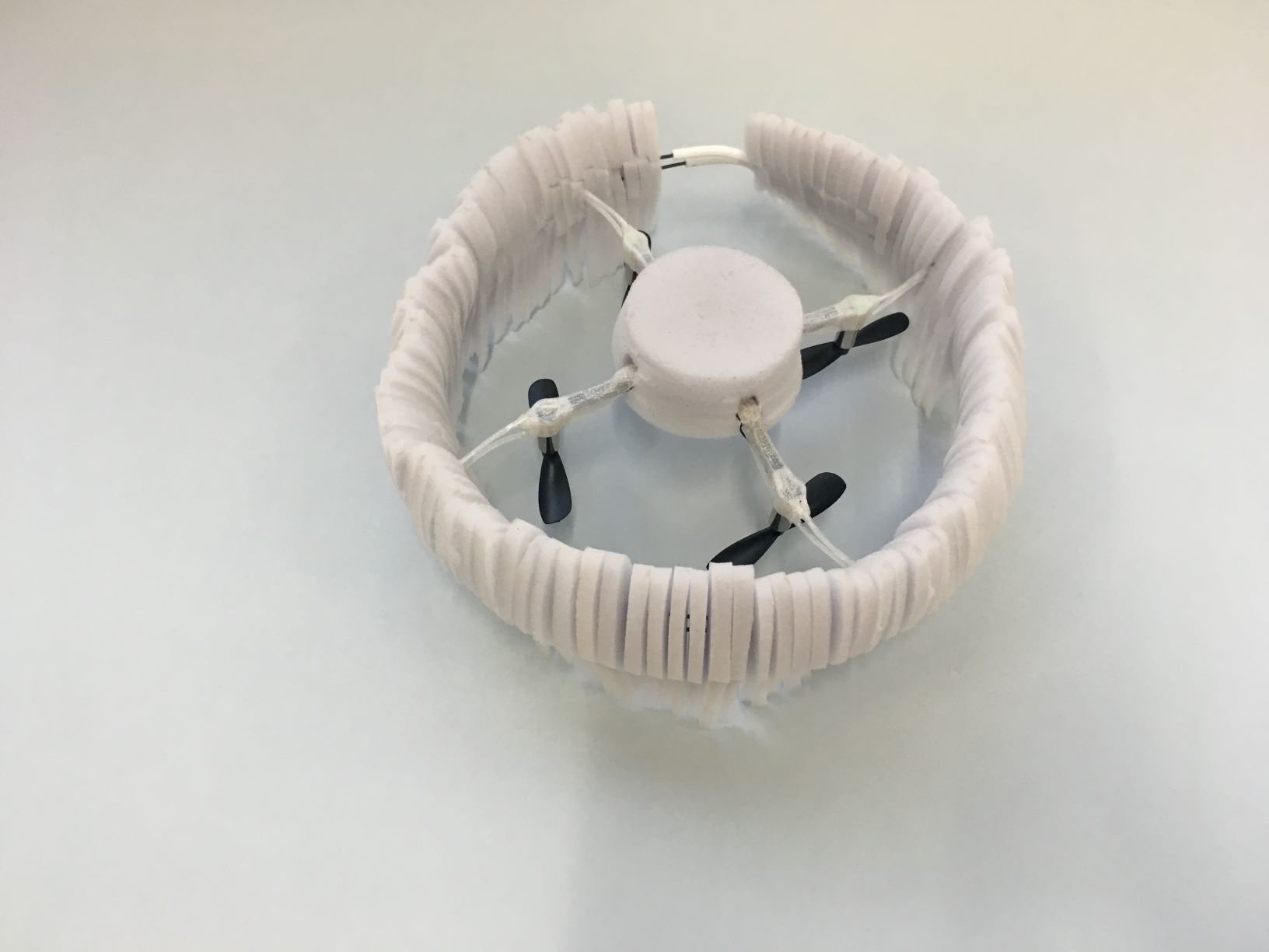

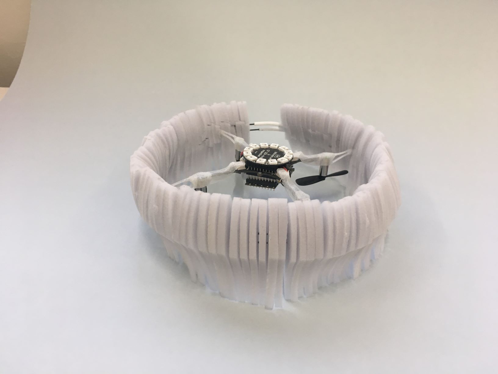

I am trying to fly the drone in the proposed configuration (see attached picture or first prototype). as I want the LED ring mounted on the top which is why I am trying to figure out how to flip the viewtopic.php?f=5&t=3311&p=16063#p16063.
I have flown the drone without the foam skirt with decent results but not terribly stable so I thought I should tune the PID.
The drone does not have to be agile or acrobatic, the smoother the flight and the slower it reacts the better. (I have sent you a video of the application via PM)
