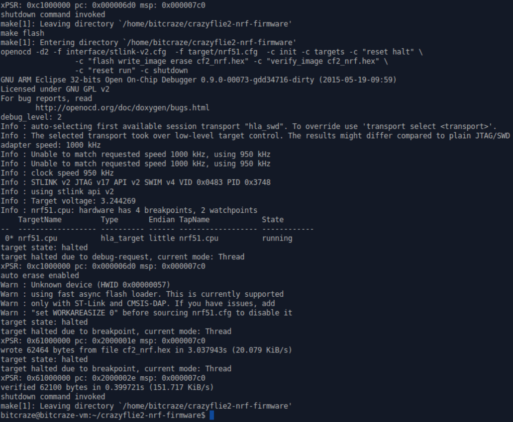

I flashed the firmware to a brand new NRF51822 by the command 'make factory_reset'. All of the MCUs in my drone are brand new, meaning no programs or no correct programs have been flashed to them before. The method of flashing is soldering STlink cable to four NRF debug pins on the drone and flashing by STlink. My working environment is BitcrazeVM_2018.01. The files in crazyflie2-nrf-firmware hasn't been modified.

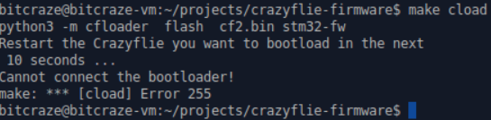

After flashing, I tried to download the code of STM32 by 'make cload' using Crazyradio PA, but it fails, showing 'cannot connect the bootloader'. The 'make cload' method always succeeded when I downloaded the program to the drones whose firmware was flashed by the manufacturer.

The pictures shows the error information when using make cload command.

Last thing is that I did encounter warnings when flashing nrf-firmware. But the flashing seems still succeeds. I don't know whether that will affect.

Here is a screenshot showing the last step of make factory_reset.
