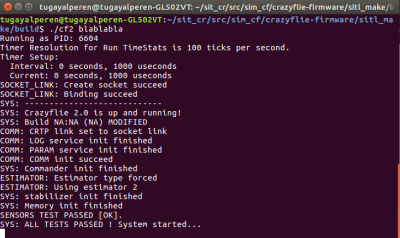

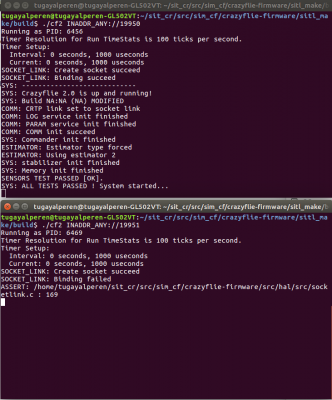

I just want to let you know, about the multiple instances of SITL (to explain, in two separate terminals, executing "./cf2" command with different arguments), the second instance can not be opened, corresponding situation can be seen at attachments. Moreover, "./cf2" command does not seem to care about arguments to be valid or not. This example also in attachments. Finally, the lines that are involving corresponding uri for sitl in crazyflie_add.launch or mav.launch files can be changed arbitrarily and simulation still works perfectly. It seems like these connections are created somewhere else regardless of ./cf2 argument or launch files. I hope that helps.

Re: HITL and SITL for crazyflie
I just updated the git. You should have a working example with two quads using only .launch file and I fixed the problem you mentioned above. However even just 2 quads in SITL on the same computer seems a lot (as you will (or not) see). I will try to see what can be done to reduce the computational load.
