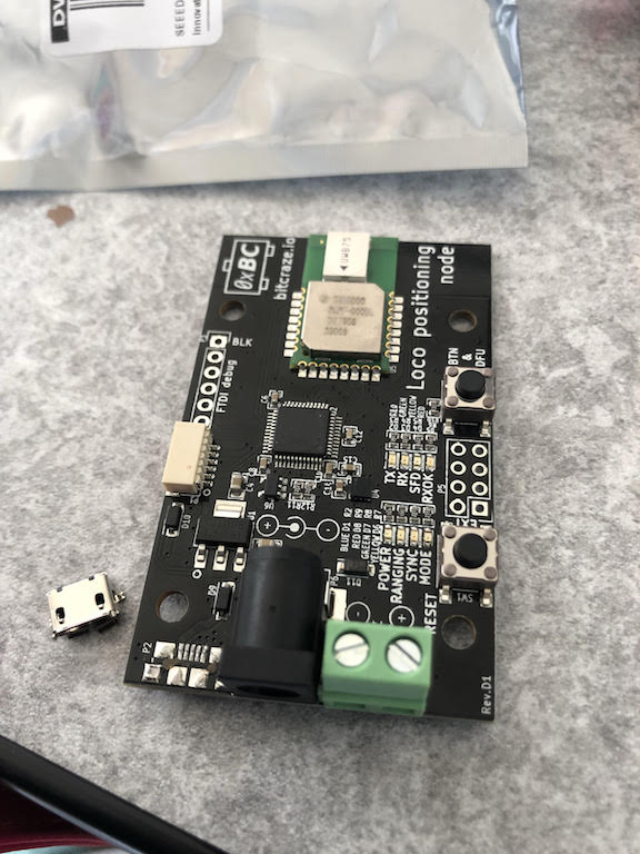

Ah that makes sense, the Node that I assigned to 0 broke (The USB power cable attachment came off of 2 of my nodes and one of them happened to be 0.) Can I use a soldering iron to put the USB power component back?

It should be possible to put the USB connector back if the solder pads didn't get ripped from the PCB. Easiest would be using hot air but it will work using a soldering iron as well. Clean up the old solder with a solder wick first and it shouldn't be too hard. Let us know how it goes!

Thanks, I dont have a soldering iron right now (Need to get one)
