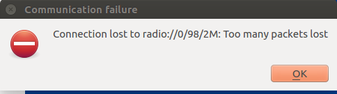

connection lost to radio://0/98/2M : too many packet lost
Post by rkd » Mon Apr 23, 2018 3:09 pm
The radio connection between CF2.0 and Crazyradio PA is lost after a couple of meter no matter of the channel or datarate.
I am using Ubuntu 16.04, Logitech, Inc. F710 Wireless Gamepad [XInput Mode]. I tried following approaches to fix it -
(1) successfully flash bin/cradio-pa-0.53.bin firmware to the dongle
(2) tried with several combination of channels and datarate
(3) tried another CF2.0 and tested with other usb ports of my PC
(4) read different discussion threads in the forums like -
viewtopic.php?t=1372
http://blog.crazyflie.net/?p=18
https://wiki.bitcraze.io/projects:crazy ... leshooting
I think there might be problem in the dongle's radio range, not sure.
Looking for the solution. Thank you.
