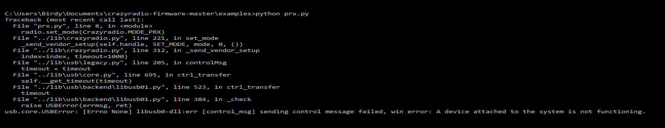

However thanks to the other threads on here that has been resolved. I then had an issue where the USB lib was not found, again thanks to this forum this was solved again after reading through other peoples support issues.
I have installed the radio drivers using Zadig, using libusb-win32, WINUSB and libusbk, each one being installed as the driver and as the WCID driver. I tried them one by one to see what difference this makes, replacing the driver to prevent any conflicts.
In my device manager the radio is recognised, and the computer states that the device is functioning properly. I have now come to a new error when I try to run the example scripts included (prx.py and ptx.py). I receive an error stating that the sending of a control message failed. I have included a screenshot of my output for you to see what is happening.
