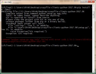

Hi developers,
I want to run the crazyflie client on my Windows PC with commands: cfclient, cfheadless, cfloader and cfzmq. But when I run the command: pip install -e .[dev], I got an error described in the picture below.I want to know how to solve the problem, thanks!
Posts: 1888
Re: run the crazyflie client on my Windows PC with commands
Post by arnaud » Tue Jan 16, 2018 1:53 pm
You should either clone the client from git, or install it from the released package with "pip install cfclient".
If you want to run from source, you need to clone the client from git.
