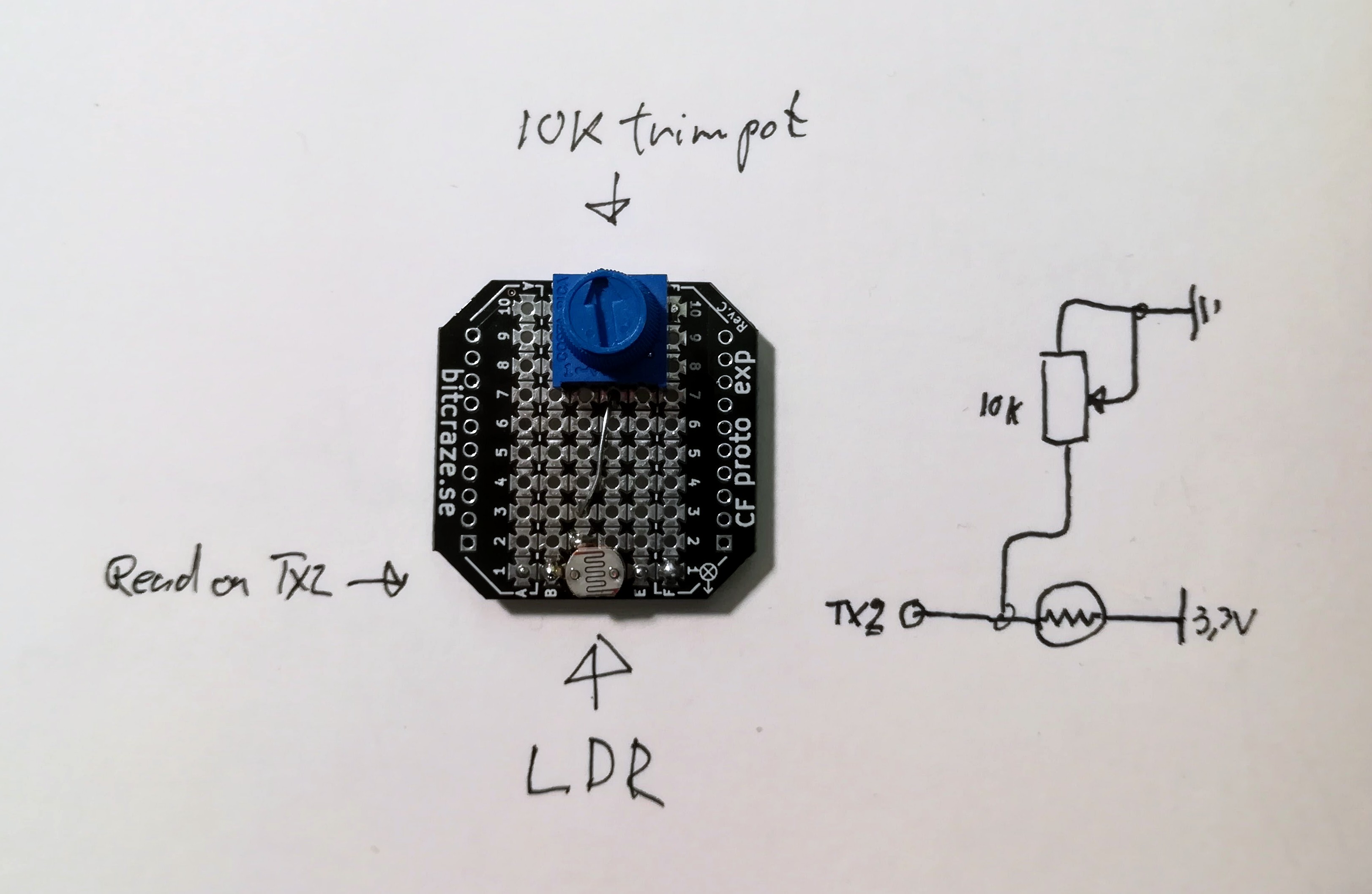

Hi All.
I'm currently doing a project, exploring how UAVs can be used for environmental surveys, in an architectural context.
I've been spending the last week trying to properly understand the i2c interface on the Crazyflie, but in the end had to give up, as I needed to get some data in. All about that data. So I grabbed the trusty LDR, a photo deck and a trimpot, since i didn't know the upper and lower resistance of the LDR, and threw a deck together in probably 10 mins. The driver took another hour, and presto, a flying sensor was born. The range is a little off, and it's not suitable for actual surveys, but for Proof of Concept, it's working like a charm.

Broke the female headers on my protodeck, and to avoid having to resolder things in the future, i made this little guy, inspired by breadboards. The right-most pins are connected, so you can patch from any of the left most headers, to any of the rows.
