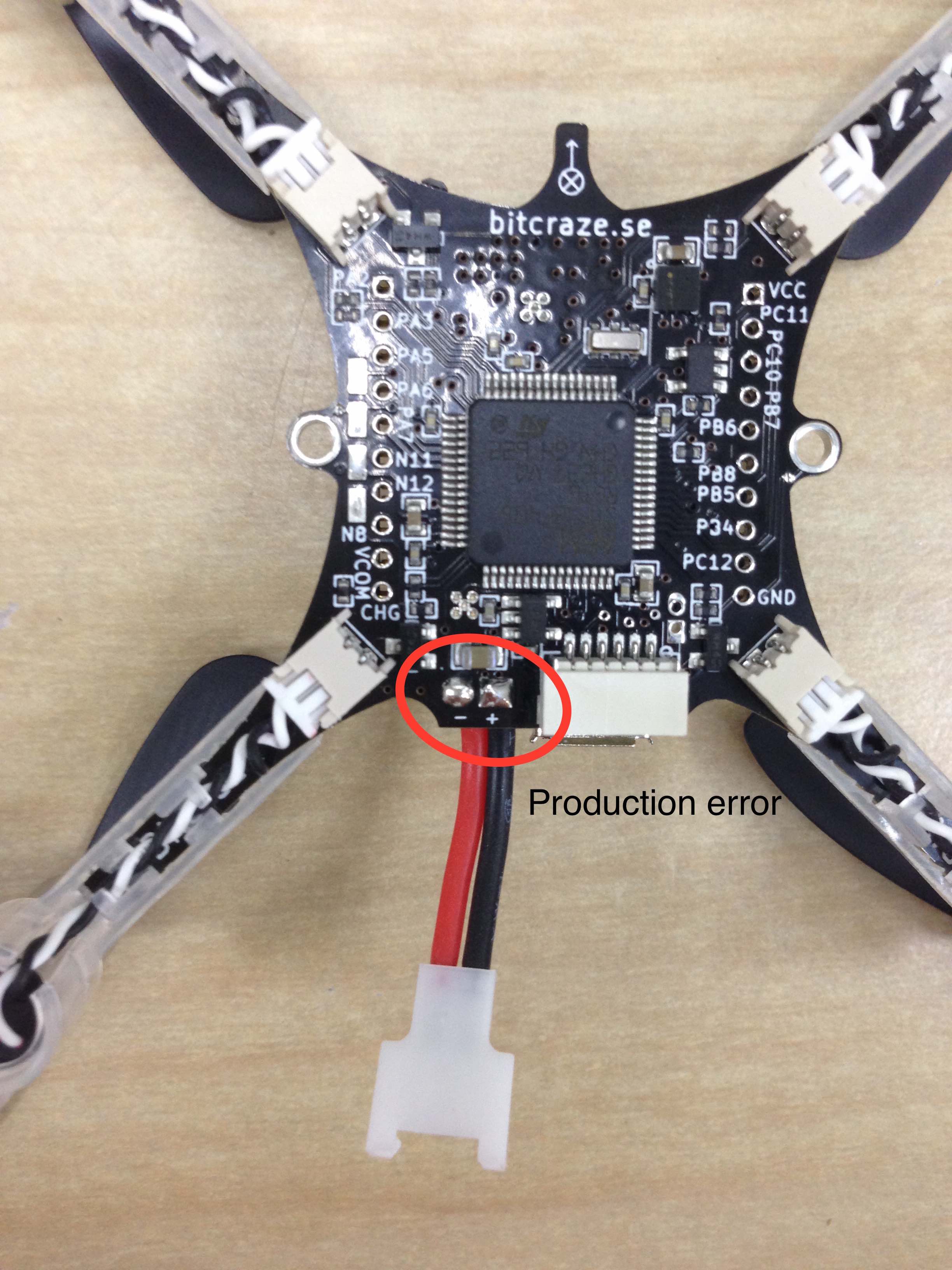

Looks like a production error. The positive and negative on the battery cable has been soldered wrong. As a first step you can swap the pins in the connector and test but of that doesn't work send us an email at support@bitcraze.io.

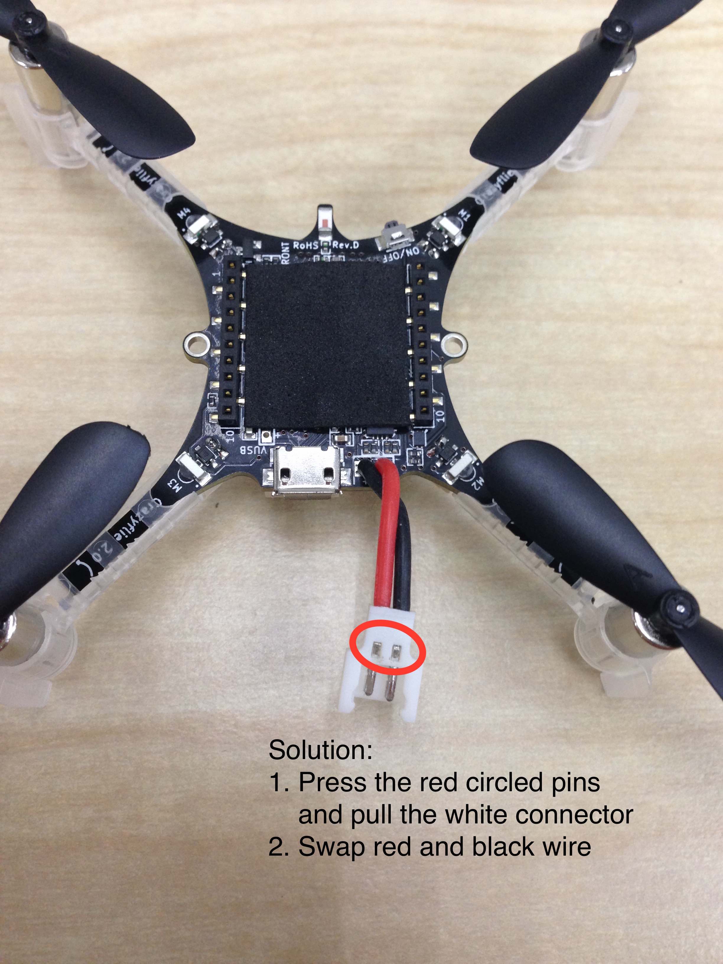

You are right!! The positive and negative wire are soldered incorrectly.
After swapping them as the attached photo, the problem is solved.
