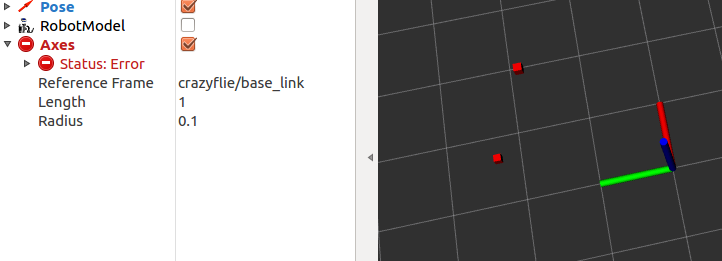

For the ROS visualisation you can disable the robot model and add something else like axes. I am not sure why the green block does not show anymore, this is a bug, but axes are better anyway since it will show the orientation as well:
(in my screenshot there is an error since I have no Crazyflie connected, but once the Crazflie is connected the axis is going to show its orientation). It is a bit odd to have it so big, but is has proven very useful for debugging. Maybe I should push it by default,Re: A few questions about nodes and placement
Great i will try switching out models with axes!
Hope you have good Yule-festivities btw
