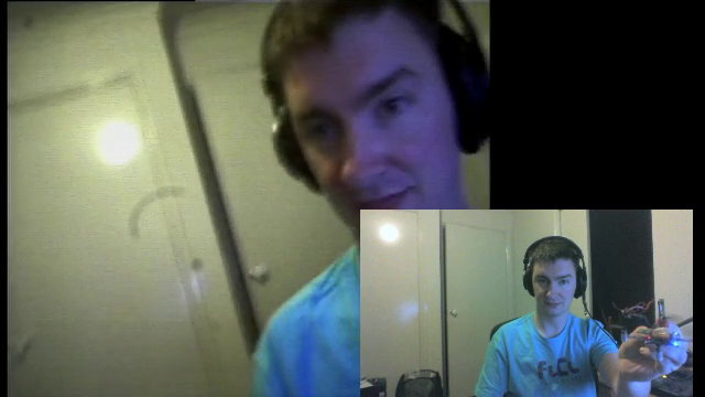

After much testing, I started to have success in sending a video signal wirelessly
The wiring description which I should wikify at some point:
http://forum.bitcraze.se/viewtopic.php?p=2673#p2673
Video of the setup and how it's been done
http://www.youtube.com/watch?v=Zps4C9ko-dU
