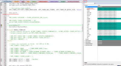

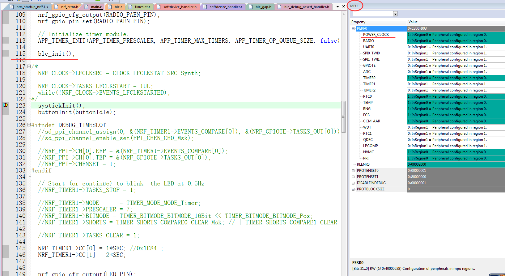

Now,there is a proplem that the code
ble_init();
has done and debug to the line
NRF_POWER->GPREGRET |= 0x20U;
will cause to a HardFault_Handler.
And I view the MPU register value like the below picture:
AS the picture the POWER_CLOCK of MPU PERR0 is written '1',so POWER_CLOCK are protected by the MPU,this is cause a HardFault_Handler reason.
