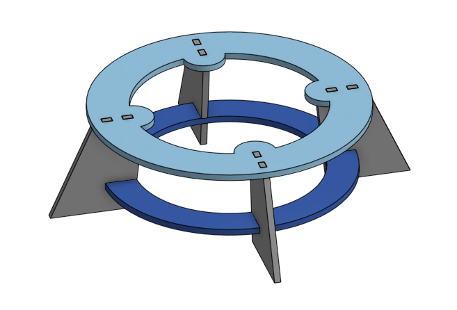

currently have a "stand" that is a workaround for the problem. even 50mm from the ground allows for stable takeoff.
