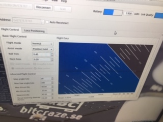

Yes, I was able to assign locations last night. I think it would be helpful in the isnstructions that it might take 15 seconds before you will see the color go from red (you just wrote to position) to green system is updated.
The new issue is my drones are sitting flat in the center of the LPS but the flight control shows them spinning. I only to trying to fly one drone at a time, but I have several and they all are doing this now.
IMG_4106 (1).JPG (29.63 KiB) Viewed 6502 times
I have more 30 hrs into this and I yet to fly a drone with LPS. I do appreciate the help.
