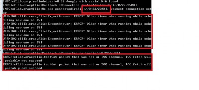

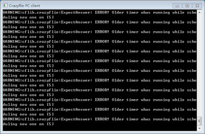

				I have tried to use the RADIO links CF,but no link ,As shown in the figure below... According to >?
			-  no link

				It looks like firmware/software compatibility issues. Try
upgrading to the latest firmware on the Crazyflie and cfclient.

				tobias wrote:It looks like firmware/software compatibility issues. Try
YES ,I feel ......
but...pls checking follow it ......
			-  not secceed
what's this "TOC Channel" ???

				Please upgrade to the latest client/firmware and this should be fixed. The TOC channel is a logical channel used for downloading a table of content of the variables that can be logged and set as parameters.
