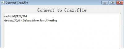

goodnews ! I try to use "cloader.hex" programming to a my CF, then via USB discovered what.. The diagram below. but I still can't wireless upgrade my CF.
what's this ? .......radio://0/122/2M ????
Re: How to determine CF Radio for effective working status?
It means it found the Crazyflie on channel 122 and 2Mbit datarate. Can you connect to you Crazyflie?

==============================tobias wrote:It means it found the Crazyflie on channel 122 and 2Mbit datarate. Can you connect to you Crazyflie?
yes...... it can connecting CF by easy Connect mode on the Client (CF has download cloader.hex, the system running ok..... ), but not connecting boot mode ......i feel "radio://0/122/2M " is't a valid radio ...... pls help me !!!

Hi, The 122 is a channel that can work.
If you want to flash something with the bootloader you have to flash one of the released firmware: https://bitbucket.org/bitcraze/crazyfli ... /downloads or one that you built.
