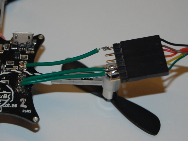

Are you planning to use it for debugging? We use a 3.3V FTDI cable and solder it to the expansion port as shown in the picture.
Expansion pin - FTDI cable color
3 - Yellow (STM32 TX)
5 - Orange (STM32 RX)
18 - Black (GND)

Do i have to remake the firmware with DEBUG=1 or other options?
Re: How can i get the crazyflie debug_print by the stm32 UAR
It should be enough by setting
DEBUG=1 is mainly to be used for JTAG debugging.
CFLAGS += -DENABLE_UART          # To enable the uart
CFLAGS += -DDEBUG_PRINT_ON_UART  # Redirect the console output to the UART
