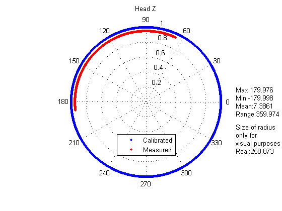

It is working! The yaw reading is spanning 360 degrees and it does not drift. :) I had to get lots of data to do the calibration and I removed data out of range.
X axis: Data point
Y axis: Angle

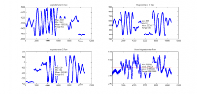

I do not have an account on bitbucket yet, : P. I was doing more testings and it seems the calibration does not work if the CF is tilted too much. More over, I think only the hard iron calibration is needed, the one that adjust the offset of the readings. Below is a graph of the raw data:

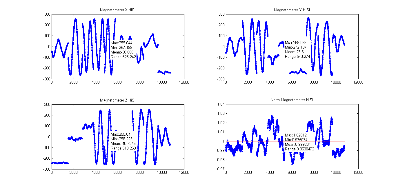

After hard iron calibration the norm is around 1, which means the sensor is OK. Now for both hard iron and soft iron:

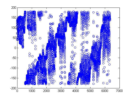

The norm is also around 1. In both cases the output for the heading is almost the same, tested on the CF:
Now, the heading spans 360 degrees. To calculate the hard iron and soft iron matrices I used this information:
