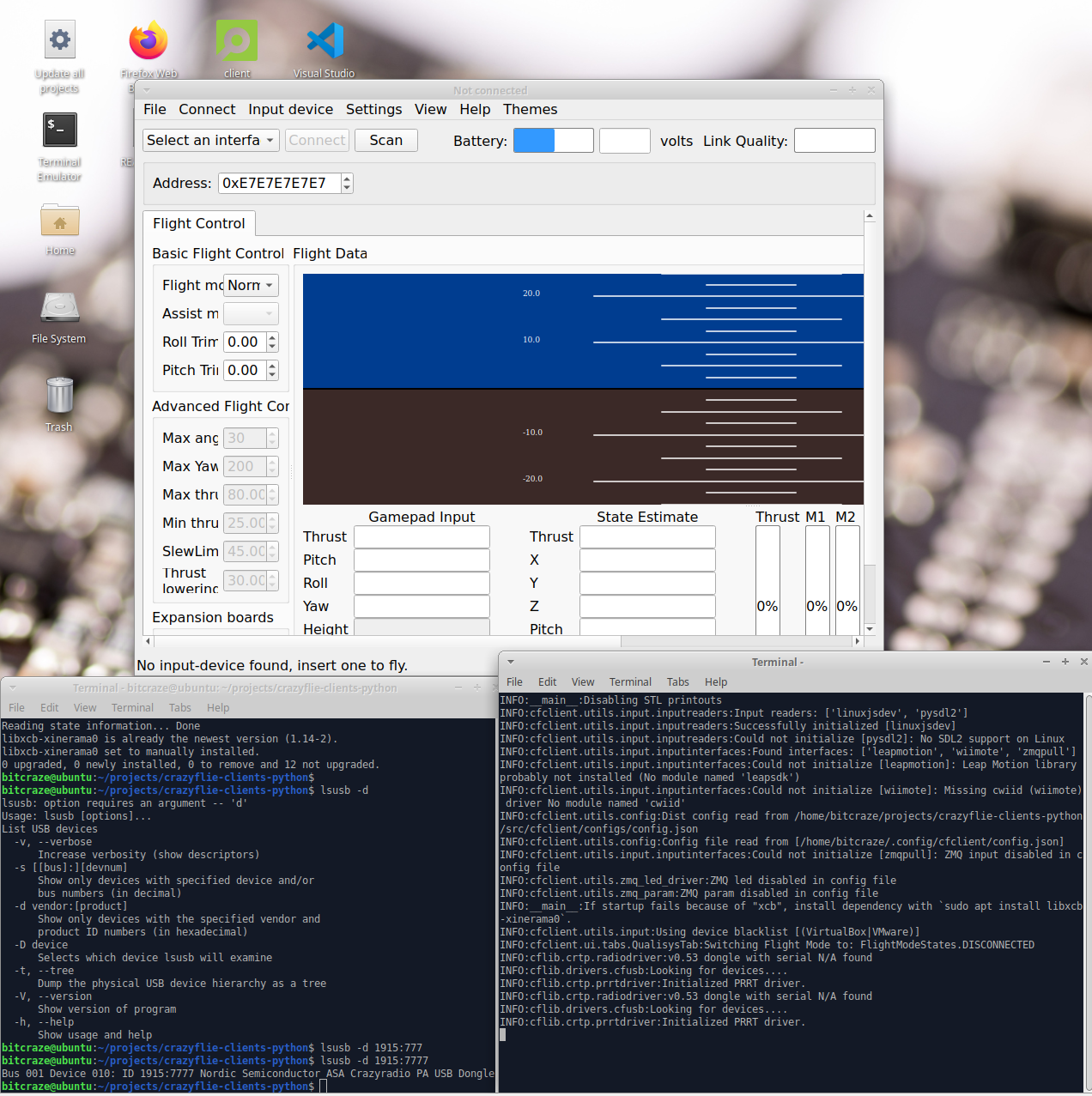

I'm unable to connect to my radiopa, I'm using a windows 10 + linux VM.
I tried to reflash firmware and other things, but everytime I plug the device it quick flashs red and green and when I try to scan, the red led turns on for a while and when the scan finishs, it turns off and it doesnt show the radio in the interface's dropdown. My crazyflie is turned on and my usb device is active in my VM, so then I have this as output for
lsusb -d 1915:7777
Bus 001 Device 010: ID 1915:7777 Nordic Semiconductor ASA Crazyradio PA USB Dongle
INFO:cflib.crtp.radiodriver:v0.53 dongle with serial N/A found
INFO:cflib.drivers.cfusb:Looking for devices....
INFO:cflib.crtp.prrtdriver:Initialized PRRT driver.
