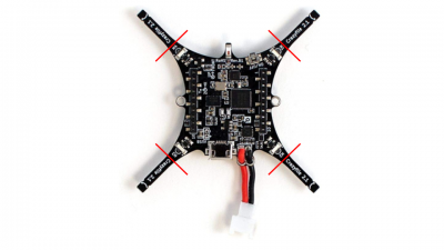

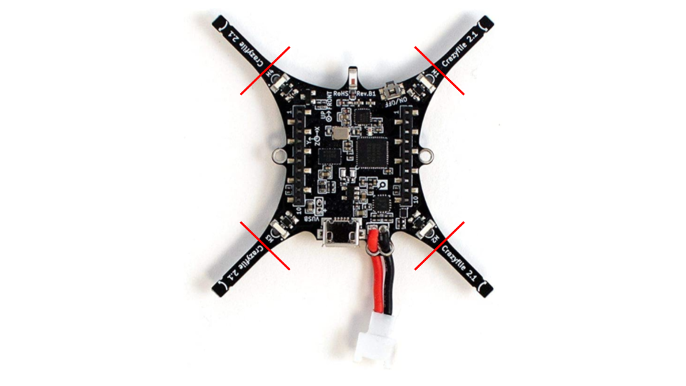

In our design, we would like to cut the arm's section of crazyflie PCB to make it compatible with our frame (The cutting lines are shown with red line in the following image). Since I couldn't find the PCB of crazyflie 2.X, I have no idea about the circuit tracks' pattern on the crazyflie. Is there anyone here to tell me is it possible to cut the arms from these lines?

Yes, cutting here will not break the board. There's no traces along the wings after the LED, only ground plane.
