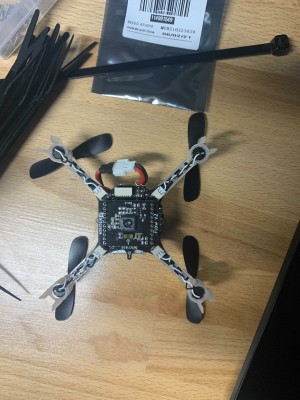

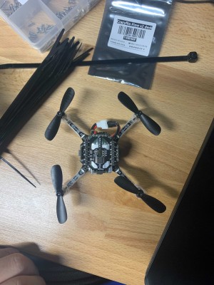

Hello all,
Just got my Crazyflie 2.1 with multi-range deck and flow deck. I have assembled everything and the two decks. I have also ran the update_all_project.sh from the VM.
I tried to fly it around with the multirange_push.py, it seems to drift. I have then realized I have not updated the firmware. After I updated the firmware with cfclient to 2021 June version I think, I tried to run multirange_push.py again and it cannot take off. I tried to adjust the battery to balance the weight.
The little debugging I did afterwards is tried to check the cfclient. The state estimation of crazyflie is blowing up when resting on the ground. Either X,Y, or Z escapes to 100 and EKF supervisor resets the states. I am assuming since Z is always increasing (as it is resting on the ground), PID does not realize that the drone is not taking off.
I am wondering is there any steps that I have missed? And I guess what steps should I take to make it more stable.
Here are the assembled crazyflie in the attachment.

The console output shows that the deck is correctly detected at startup. Are you sure that its flying over a textured, non black and reflective surface?
So with the behavior that you mentioned and the fact that it loses height, might be that the deck loses connection with the crazyflie midair. Your pictures do show that the decks assembled the right way, but perhaps a way that you can check this, is to use the plotter tab and check if the crazyflie stops getting measurements of motion.deltax/y mid air if you control the crazyflie with an controller if you have one.
You could also double check if the multiranger is working in combination with the flowdeck as they are using the same i2c port. The plotter value is called range.(direction)
