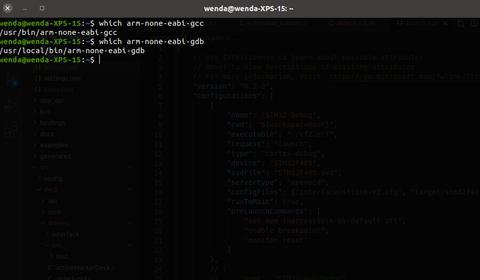

As a first step could you verify for me that you have the arm-none-eabi-gdb binary on your system?
It should probably be in /usr/bin/arm-none-eabi-gdb ...

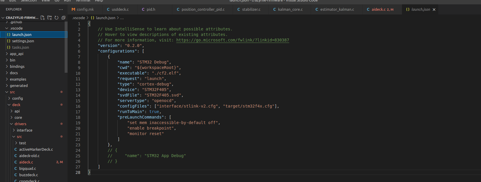

Could you also paste the contents of your launch.json here? Thank you.

Thanks for the reply. The attachment is the screen shot of the arm-none-eabi-gdb and launch.json file.

Perhaps you need to add:
Or "/usr/local/bin/arm-none-eabi-gdb"
"cortex-debug.gdbPath": "gdb-multiarch"
