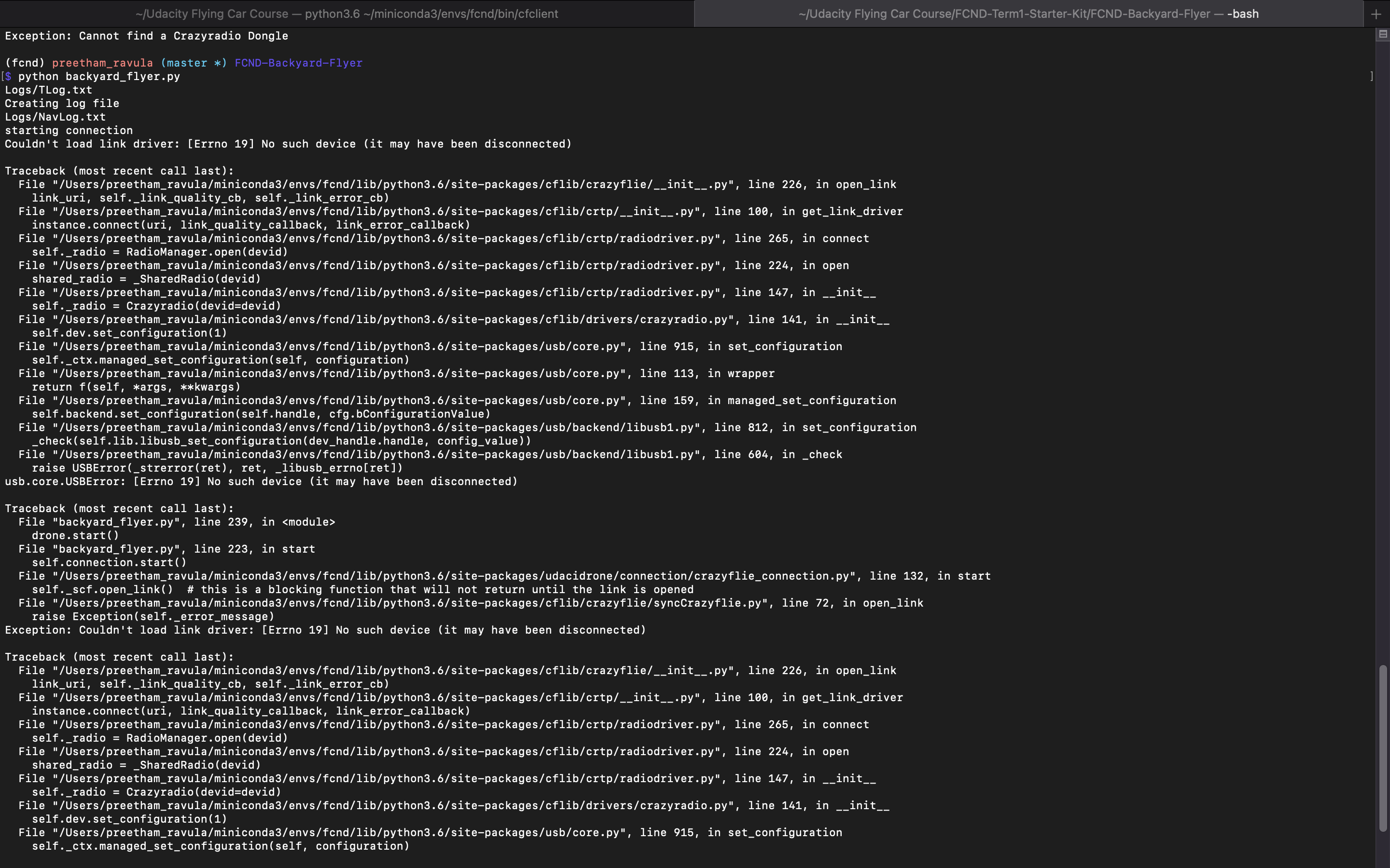

A bit of background I am using a Macbook pro with OS Monterey and a ps3 controller, I am trying set my Bitcraze drone to perform a square as part of the Udacity flying car course for backyard flyer project, I setup my client and connected the radio dongle it seems to recognize the dongle but when I run the script it shows the following error That i attached below, I tried this in a windows machine and also the Bitcraze VM but the issue persists, can some one please tell me what the issue is and how to solve it? I am also providing a link to the script i am trying to run, please let me know, thank you all.

Hi! Usually more actions are required to have the computer read out the crazyradio, which are different for each operating system you have. Are you sure that you followed all the instructions on the installation page ? Perhaps you didn't install libusb? On the VM it could be that you didn't install the USB expansion pack for USB devices for VirtualBox.
