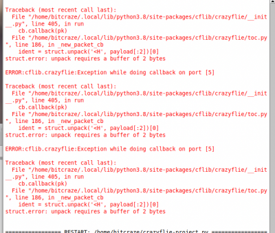

I am using the BitcrazeVM. I wrote a python program that uses the MotionCommander and threads to fly 5 drones using one dongle. The Threads are given different arguments so that the drones all fly a unique course. This program runs fine at my house. However, when I run the same program on campus in my school lab I get this Traceback error (Screenshot attached).
I've tried on several different occasions and get this error when I run 4-5 drones on campus. With 3 or less drones it will run fine.
I took the drones home again and the script runs fine with 5 drones at my house.
What could be causing this?
Does anyone have any suggestions on what I could do to fix this issue?

This is hard to debug without knowing more! We do not know of any general thing that could lead to this. By the way, have you tried using the Swarm class to control them instead of spawning your own threads? See reference here: https://www.bitcraze.io/documentation/r ... lie/swarm/
And some examples are located in the python-library: https://github.com/bitcraze/crazyflie-l ... ples/swarm

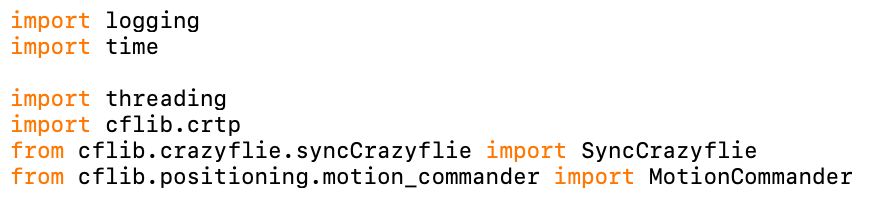

What other information do you think would be useful for debugging?
I've attached the imports my program uses
Re: Unable to fly multiple drones in another environment
So what I assume that Jonas meant is to share more of the code where it goes wrong and perhaps share an minimal example of where it goes wrong. But it seems to be already clear what your issue is.
From the imports I can see that you are not using the swarm class of the CFLIB, so please try out the swarm examples that Jonas gave in the previous post and take a look at the api
