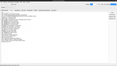

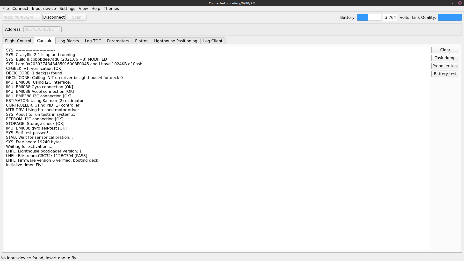

Hi crazgy!
Could you post your console log when the Crazyflie with modified firmware boots? Perhaps something goes wrong with initialization.
Jonas
Jonas
