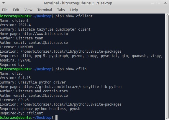

- What is the version of the lib and client?
- Do you use any VM or docker or similar?
- Does this happen without the lighthouse deck?
To check version of lib and client:
$ pip3 show cfclient
$ pip3 show cflib

Yes, I am currently working with lighthouse deck and it started since I tried to flash one of the drones. Here is the information that you may be looking for. I honestly have no clue what is happening, and to add to that, no the crazyradio PA no longer detects the drones while entering their correct address. I have tried reinstalling the libusb for crazyradio, reinstalling the entire bitcraze VM v. 2021.04, and updating the cflib and pressing the "update all projects". Please help me figure this out before it gets more serious.
P.S. In addition, when I connect via USB, the cclient takes a very long time to "connect" which is about 10-15 min of waiting for memory to be updated and then connection setup to finish on cfclient's terminal. So whatever the issue is, it basically slowed down everything.
