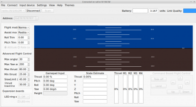

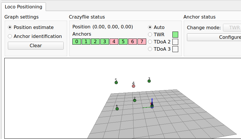

I have been conducting the setup process for the Loco Positioning System (up to positioning the 6 anchors in the room and attempting to configure the system - most specifically, at 'Check Anchor Status' in https://www.bitcraze.io/documentation/t ... ng-system/), but when I scan and connect into the system, not all of the anchors turn green. My anchors 3 and 4 (both ceiling mounted) are clearly getting power, as the lights turn on, but the red light on the anchor next to 'Ranging' flickers, rather than holding steady like it does on the other 4 anchors. These 2 anchors will swap from red to green (in the program, as I've attached below) seemingly at random, even though their locations are known to the crazyflie. Since they are clearly unobscured (and nothing is moving around in the lab) and getting power (as the other lights do not flicker) is this likely a hardware problem? Or is there perhaps some further calibration I could conduct to get more stable signals? Or perhaps this doesn't matter at all, and the occasional interruption of an anchor or two won't affect flight too much?
Thanks again!
[Attached are screenshots showing the system at various states of connection]
Thanks again!

The reason the indicators flicker between green and red is that the ranging with the anchors is not successful all the time. The question is why?
One common problem is that that the anchor is too far away, possibly combined with other factors such as interference with other radio sources. The antennas on the Nodes/Deck also have different characteristics in different directions and the placement/room can also have an effect.
The first thing to test is to move the Crazyflie closer to the anchors 3 and 4 to see if makes any difference.
A common solution is to increase the transmit power of the UWB radios (both on the Crazyflie and the Anchors). you can find some instructions here viewtopic.php?f=16&t=4731

Thanks for responding. I tried moving the CF closer to the anchors, but this doesn't seem to effect the signal at all. I remeasured my space, and I actually have the anchors set up in a slightly smaller space than recommended (one dimension of the rectangle is less than 2 meters), so I doubt the distances being too far was the problem. I also noticed another peculiar detail, which is that the CF always believes itself to be at location (0.00, 0.00, 0.00), regardless of movement - the anchor identification worked fine, as the appropriate green circles would grow when it was moved near any of the six anchors, but there was never any response or change while in the position estimate tab. I also tried to fly in this state, which was not possible.
After conducting these further tests and observations I tried to follow your instructions on increasing the power from the anchors, but after trying this with 2 of them I realized that I could no longer get the red RANGING light on those to turn on at all - and further attempts to get the anchor identification tool to work have failed. Now anchor 0 (one of the anchors I attempted to increase the power of) is also marked in red on the program, and I worry I have made some error and worsened my problems.
So, my questions are now two-fold - is there a way to reset the system to back before I attempted to raise the power, as something has clearly gone awry? And does the fact that the crazyflie is oblivious to its location, yet could tell the location of the other anchors help solve the original problem at all?

It all sounds a bit weird, I'm not sure what is happening.

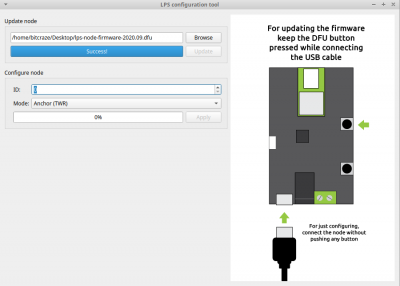

First, it is easy to reset the nodes so getting back to a clean state is no problem. When connected to an anchor using a terminal just press 'd', this will reset all settings factory settings. From the help menu:

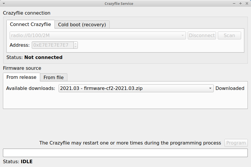

Secondly, have you updated all software/firmware to the latest versions, especially the nodes and crazyflie?
Loco Nodes: https://github.com/bitcraze/lps-node-fi ... ag/2020.09
Crazyflie: https://github.com/bitcraze/crazyflie-f ... ag/2021.03
What I find odd is that it seems as the Crazyflie is ranging with most of the anchors (since the indicators are green) but your estimated position is still (0.0, 0.0, 0.0). The estimated position is based on input from the Loco system but also from the IMU and the noise only from the sensors should move the estimated position.
At this point I would suggest to make sure all firmware is updated, reset the anchors and reconfigure the system as a first step. Let us know what the result is and we will take it from there.
It is not surprising that the anchor positions are displayed correctly, they are stored in the anchors and are transferred to the Crazyflie (in UWB packets) and then to the client (via Crazyradio). This shows that you have set reasonable anchor positions and that communication works all the way. That is good!And does the fact that the crazyflie is oblivious to its location, yet could tell the location of the other anchors help solve the original problem at all?

Thanks for sticking with me on this. I went through the steps you listed, and I was able to reset the nodes back to their original settings, and went through with the setup procedures again. I also replaced my anchor 4 with a spare, thinking its lack of connection might have been a hardware problem. The new anchor seems to be more reliable, but it, 3, and 0 still occasionally flicker in and out. As far as I can tell I've updated all of the firmware (using the 'Update all Projects' tool on the VM Desktop) and updated the CF and the anchors to their most recent versions (as attached below), and I'm largely back where I started. The anchor identification tool works with this rebooted setup, and position estimate still does not - with a constant readout of (0.00, 0.00, 0.00).

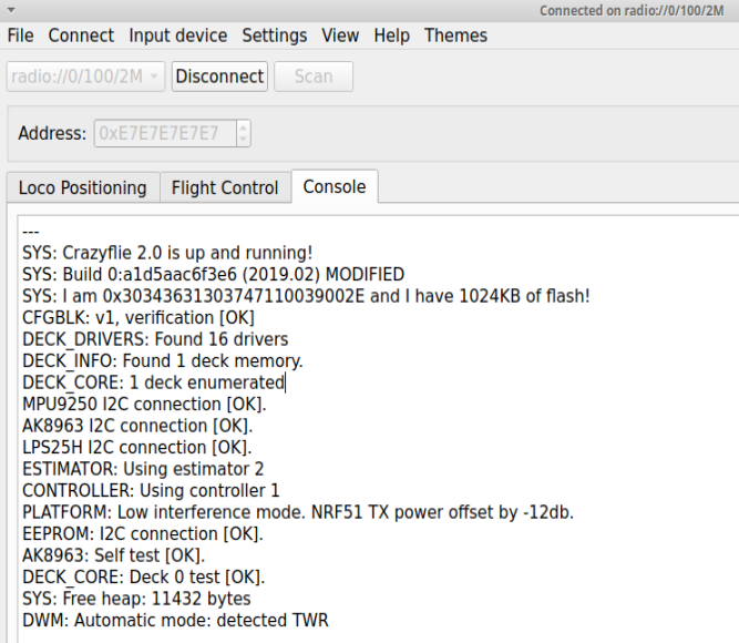

2. Reboot the Crazyflie, connect to the client and switch to the console tab. Copy/paste the log here to enable investigation of the start up provcess.

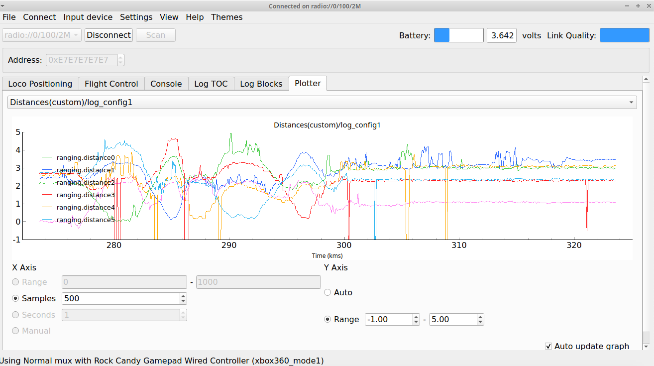

3. Set up logging of the measured distance to the anchors. This requires a few steps, you can read about how to configure the logging here: https://www.bitcraze.io/documentation/r ... t/#logging and how to plot it here: https://www.bitcraze.io/documentation/r ... otter_tab/
The logging variables to use are ranging.distance0, ranging.distance1 and so on, they will show the distance that are measured to all the anchors.
Switch to the plot tab and plot the ranges while you move the Crazyflie around a bit and check if the plotted distances makes sense.

2. Here's the log - I hope this is helpful! (Attached)
3. The plotter works! It didn't when I first booted up the system, but I restarted everything and it is very clearly showing the distances to each of the anchors. The signals aren't exact, and there are points where they drop out and then recover, but overall it's an accurate estimation of the CF's location. The anchor identification tool still works, and the position estimate still does not - It will show a constant location at (0.00, 0.00, 0.00) despite the fact that the plotter is accurately describing the distances in the next tab. (Picture of the plotter while I walk around with the CF is attached)

The console log looks OK, no problem there.
I also think the plot looks pretty OK.

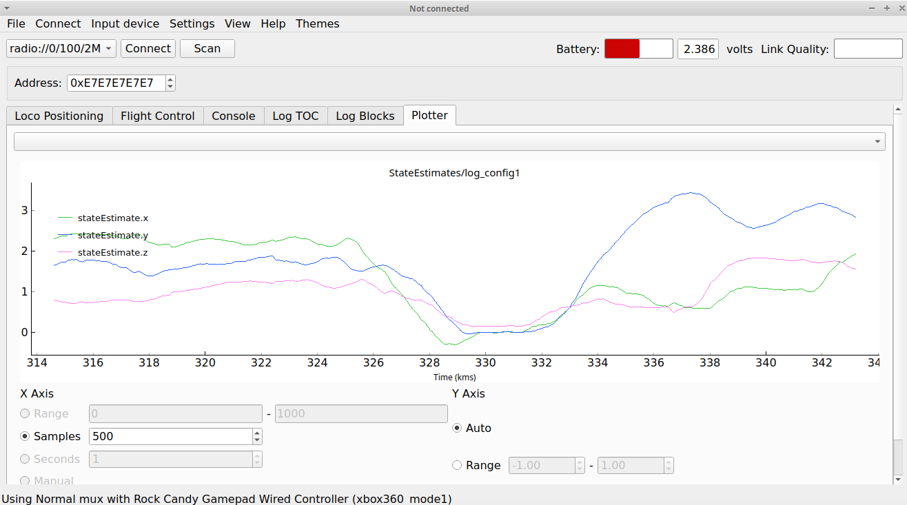

It could also be interesting to set up logging/plot for stateEstimate.x, stateEstimate.y and stateEstimate.z which are what is supposed to be displayed as the position in the client.

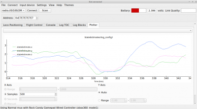

Re: Ranging Light on Anchors Flickers, Connection Intermittent
I set up logging for stateEstimate x, y, and z, and they work exactly as one would expect. Low values near the origin I've set, which increase when moved away.
