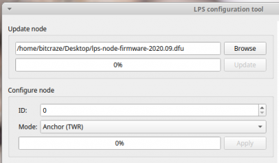

In setting up my LPS system, I came across a problem when attempting to update the anchors.
I was following the steps at "https://www.bitcraze.io/documentation/t ... ng-system/", and was on 'Update the Nodes', after installing all of the relevant files from the linked github (using the linux versions, as I am using the Virtual Machine), but found that even if I plugged my computer in while holding down the DFU button, I could not update the nodes. Instead, when I select the lps-node-firmare-2020.09.dfu file in the LPS configuration tool, the Update button remains grey and unclickable (see attached screenshot).
Is there some step I've missed that might affect this? Is there a specific folder that lps-node-firmware-2020.09.dfu might need to be moved to, or perhaps the LPS configuration tool itself needs to be moved? Any insight would be appreciated.

Hi!
In the virtual machine, you usually have to select which USB device is ported to the VM. If you are using virtualbox, that is in the top menu with devices/usb/ and you will see a list of usb devices that are currently connected. Have you done this already?

I had forgotten to connect the usb - that solved it, thank you!
