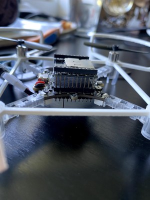

Dear All,
I have received a SD card deck and found some problems while installing. When all pins are connected the crazyflie will not connect to the cfclient or any running program anymore. This seems to be caused by an ID error in the memory chip with some other system in the crazyflie, making the system test fail and thus not starting the software. To avoid this I disconnected the memory chip pin which makes this problem solved.
See the picture for my installation, third pin on the left.

Re: uSD-Deck Problems
The problem is very strange. It looks like the Crazyflie thinks the SD card deck is a test deck. To me that sounds like the 1-wire memory is configured wrong but how that has happened I have no idea.
You can restore the 1-wire memory by running the attached script with the SD-card connected to a Crazyflie. It will run on the first Crazyflie found so only have one powered if you have many.
If it is successful then remove the forcing of the SD-card and hopefully everything works again.
