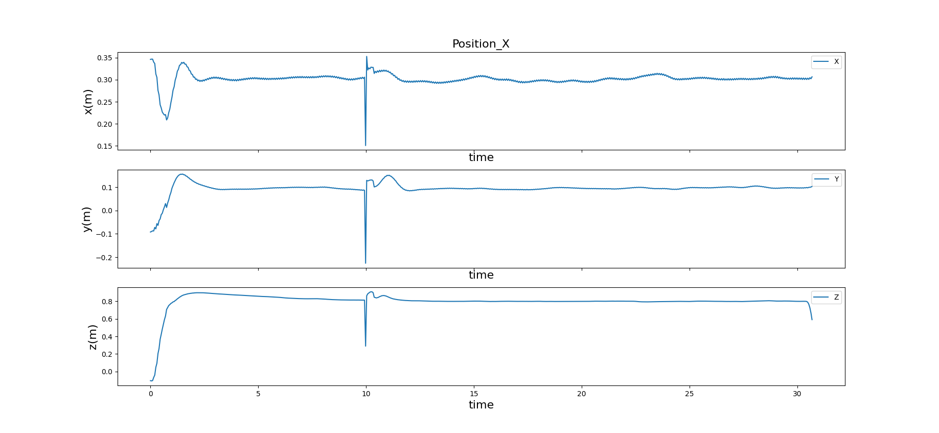

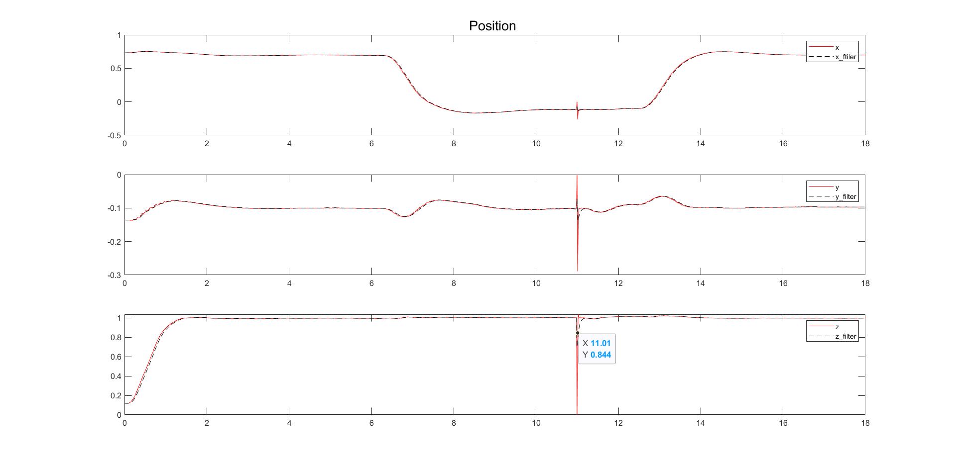

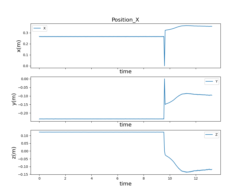

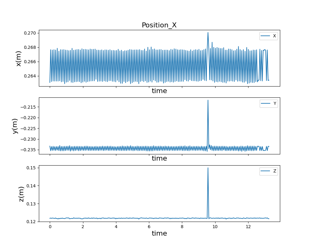

My crazyflie always hasd an sudden interference in the same time . I tried to use flow deck2 and lighthouse positioning system to get real-time position, but unfortunately, this interference always appeared. So I think this problem has nothing to do with the positioning system. I also tried to use the original firmware from bitcraze(Code unchanged), but the same problem still occurs.
Has anyone a similar problem or give some suggestions?

I think this problem has nothing to do with the controlling. Even if I do not send any commands, the copter has also a disturbance. (the firmware is unchanged, original from bitcraze). The disturbance comes sometimes large, sometimes small, but always in the same time.
