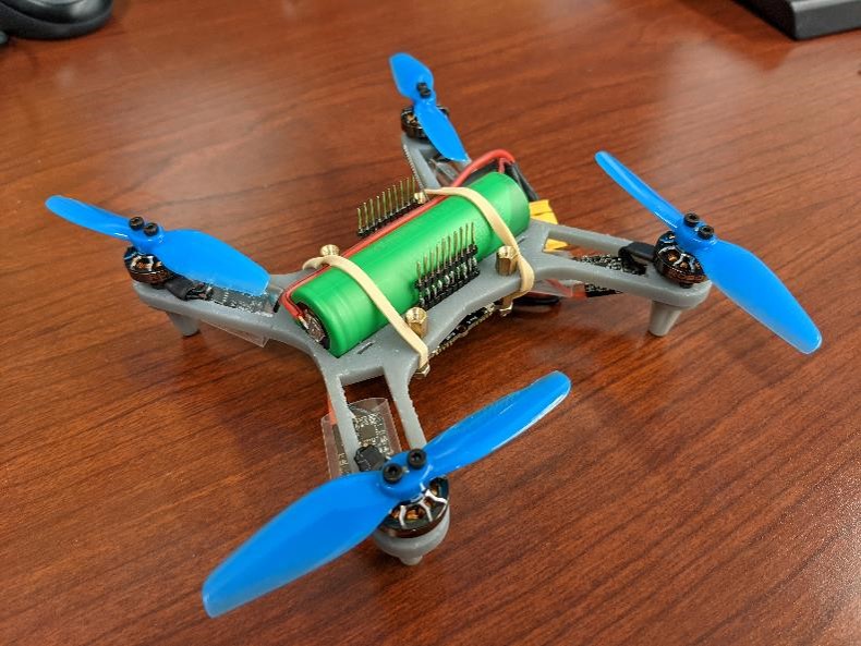

I am currently working with the Bitcraze Bolt, and I am emulating the following Bitcraze blog post as closely as possible:
https://www.bitcraze.io/2020/10/testing ... ll-li-ion/
It is going well so far, however, I am having a problem where when trying to take off the drone does not apply any thrust to Motor 4 (M4, front-left) of the drone. It seems to be able to apply uniform thrust to all other motors, however. I switched the working motor and ESC on M3 to be connected to the M4 position and this motor remains unresponsive, leading me to believe this is not an ESC, soldering, or motor issue.

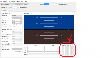

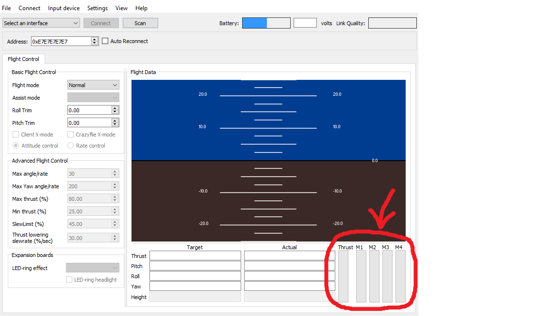

When I refer to "green" I am referring to the motor column thrust indicators in the cfclient GUI (Thrust, M1, M2, M3, M4). When I apply uniform thrust (up on my control stick), I only see thrust ("green") in M1,M2, and M3. But not M4. I'll include a pic below of where I am referring to in cfclient.

Then I suggest measuring the voltage of the M4 signal as I suggested before. I don't know what motor signal protocol you have selected but the default PWM@400Hz should give you a voltage around 1.4V when no throttle is applied. You can also try another protocol like the OneShot125, maybe this will work better with the ESCs.
