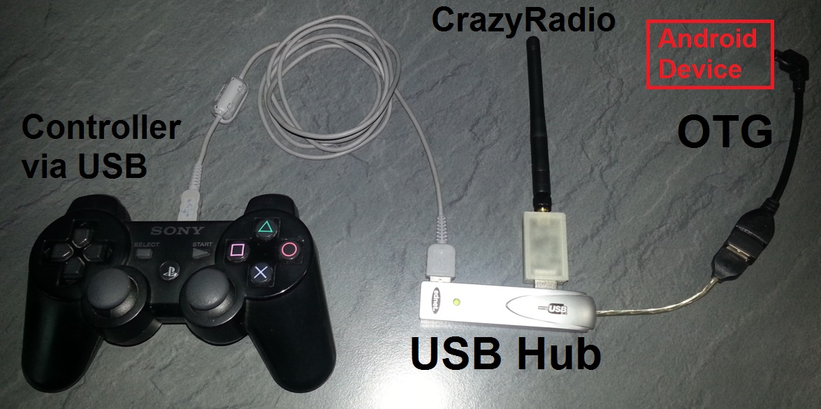

Also a possible CF APP setup with external controller (wired):
Now, i use the App SixaxisController (root needed) to fly wireless (via bluetooth) with my PS3 controller and the smartphone in the pocket.
