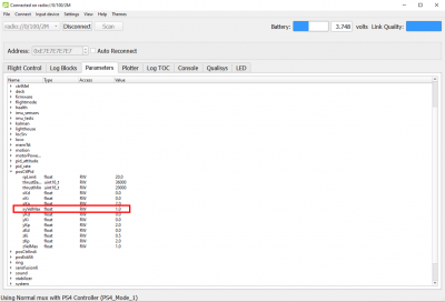

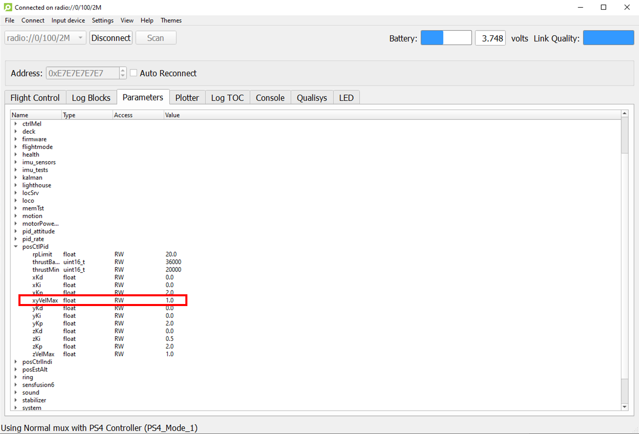

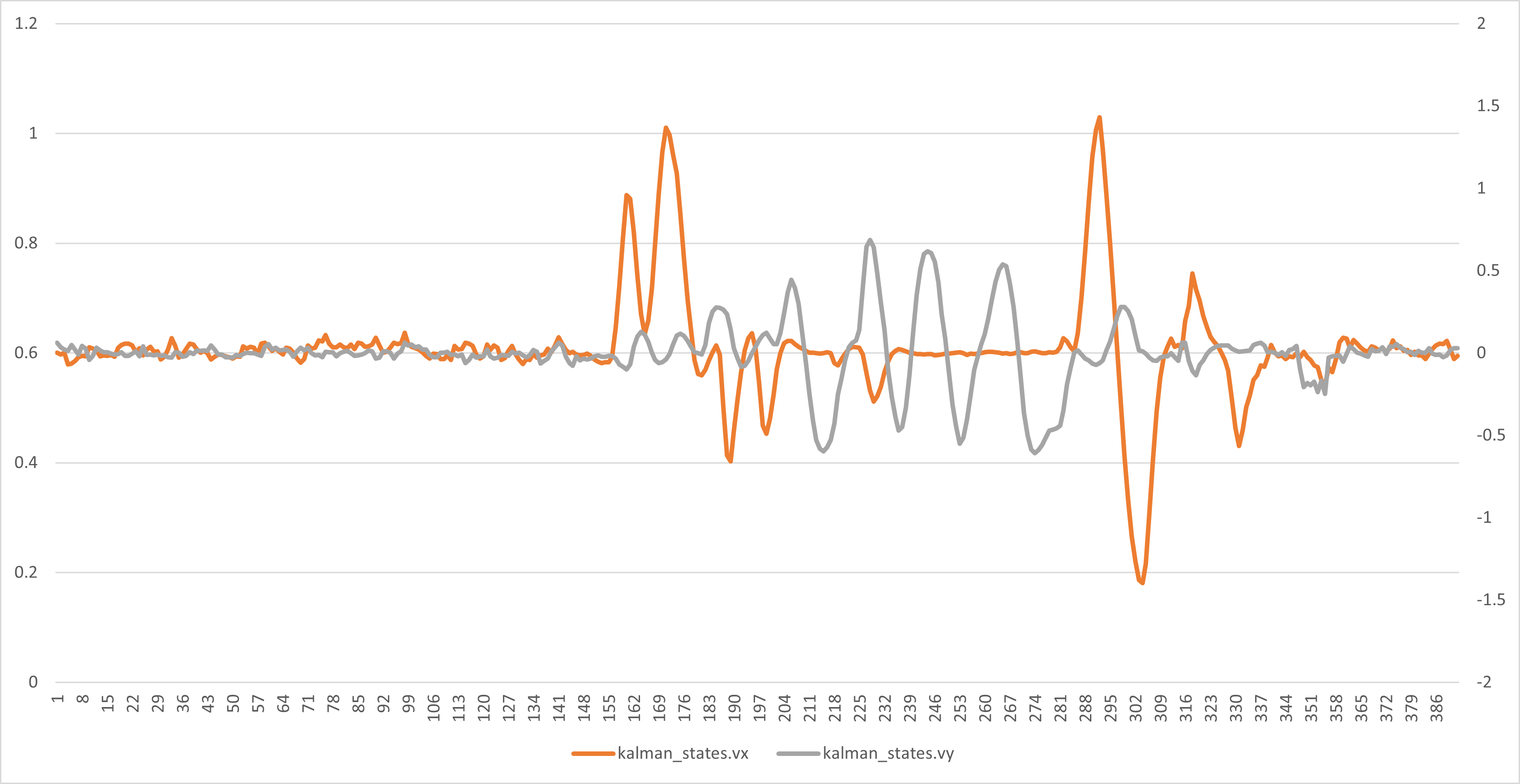

I am trying to change the velocity for flying the Crazyflie using a PS4 controller with a flow deck in Hover assisted flight. Currently, the limit for velocity is set to 1m/s by default. I was advised to change the xyVelMax (attached image) to increase the limit of the velocity. I tried to change it to 2.0 or even higher, but when I checked the log file, specifically kalman_states.vy or kalman_states.vx, the maximum value is still 1.0.
Then I also tried to increase the RPLimit and observe the changes. When I checked the log file, specifically the controller.pitch/roll, the limit did change, but the velocity still remained limited to 1.0. Would anyone know how to change the velocity?

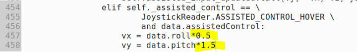

My colleagues saw this and they said to try to place a multiplier on these lines and build the cfclient again. Apparently the RPLimit is not used there.

Yeah indeed, since this is a feature that requires the source code of the client to be changed.
There are instructions how to build the cfclient from source: https://github.com/bitcraze/crazyflie-clients-python and then go to 'building from source'.

I just recently tried this. I followed the link you mentioned to setup a virtual environment in the VM. Then I added a multiplier on the variables you mentioned. I tried putting 0.5 for vx, and 1.5 for vy as seen in the image below. Then I use this code "python3 -m pip install -e ." to build the cfclient within the venv. Once I opened it in the venv, I saw that the vx and vy are having the 0.5 and 1.5 limits when I push the sticks. The Crazyflie can now move faster or slower based on the multiplier.
