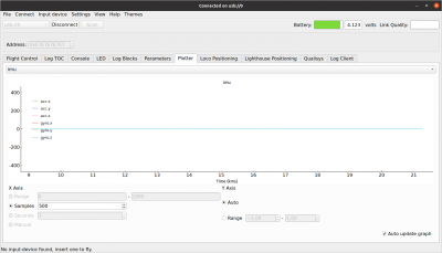

Hey there, sorry for not responding quicker, The plotter tab only provides the same output for both the working and non working drones when I connect them to the client (see the attached). It might be different for the one that can fly once it gets airborne, but I didn't test that since the other can't fly right now anyway. On the other hand the terminal logs for the cf client seem to show a slight difference between the drones. Here is the output of the working version vs the never stabilizing one. I can see that the extra bit refers to the loco deck (which I do not have, and never tried to configure) but is it possible I somehow put it into a loco deck seeking mode with the boot loader? I did not have the loco position tab open when connecting to the bugged out drone, and also didn't when I first flashed the firmware, but again any insights you all could provided would be super appreciated.

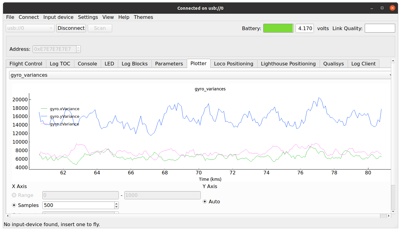

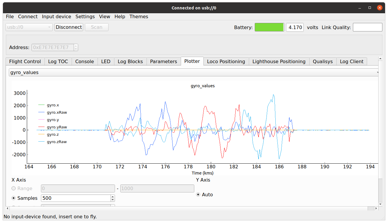

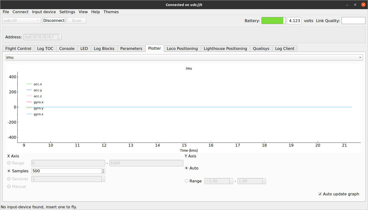

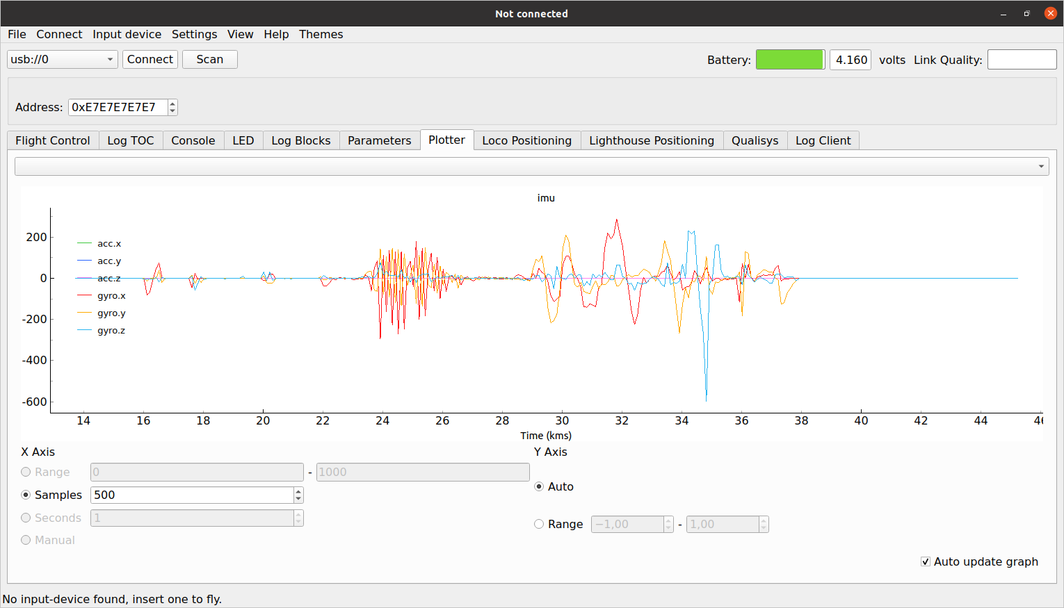

I further used the cfclient to create a log block with the IMU (accelerometer and gyro), which I then printed in the plotter. For a working Crazyflie this outputs a nice graph like here,
but for the problematic Crazyflie the sensor values simply do not change at all as seen here
Did a solution to this problem arise in the last few months? Please let me know if there's anything else I shall test with the problematic Crazyflie.

Sounds like a problem with the BMI088 IMU and that is unable to calibrate. Can you check the logging varables:
LOG_GROUP_START(gyro)
LOG_ADD(LOG_INT16, xRaw, &gyroRaw.x)
LOG_ADD(LOG_INT16, yRaw, &gyroRaw.y)
LOG_ADD(LOG_INT16, zRaw, &gyroRaw.z)
LOG_ADD(LOG_FLOAT, xVariance, &gyroBiasRunning.variance.x)
LOG_ADD(LOG_FLOAT, yVariance, &gyroBiasRunning.variance.y)
LOG_ADD(LOG_FLOAT, zVariance, &gyroBiasRunning.variance.z)
LOG_GROUP_STOP(gyro)
These should output data even though it is not calibrated. Check especially the variances. They all need to go below 10000 for the gyro to calibrate.

thanks for the quick reply. Your conjecture was correct: the variances are pretty high as seen here.
For the sake of completeness I also tracked the raw gyro values and rotated the Crazyflie around all 3 axes (first roll, then pitch, then yaw). The motion is measured by the gyro indeed (I cannot give a statement on whether the values are correct or not though).
Now we know the culprit. I wonder is there also a fix for this or is it simply malfunctioning hardware that we have to live with?
