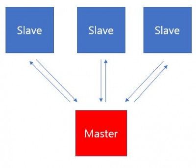

We're trying to communicate between drones in the following ways:
I'm considering three things to implement this.
1. uwb communication using LPS deck.
2. Multiple p2p communication using nrf.
3. Multi-communication using additional modules such as zigbee.
We are looking for communications that do not affect stable flights.
We are considering options for number 1 and 2 that are not required by additional modules first, and if this is not possible, we will consider option 3.
We welcome any communications case or information using the LPS deck.
Also, if you have any other options, even if it's a third, please tell me whatever information is involved.
And if there's any other way I haven't thought about it than the three above, please tell me.
