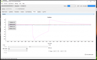

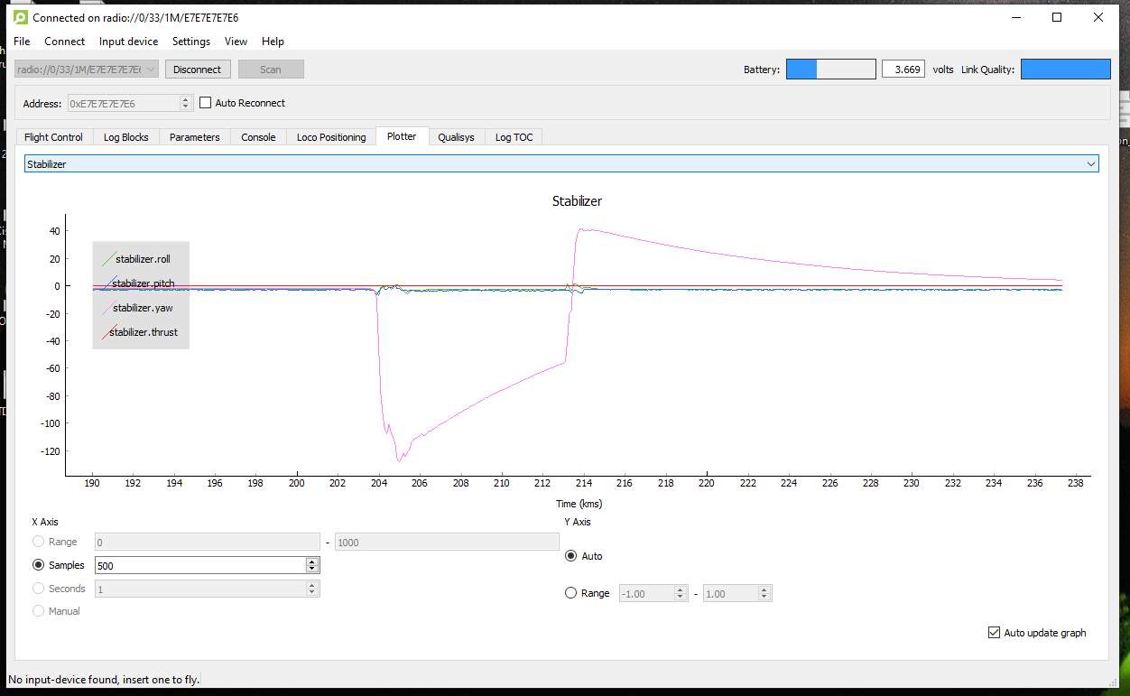

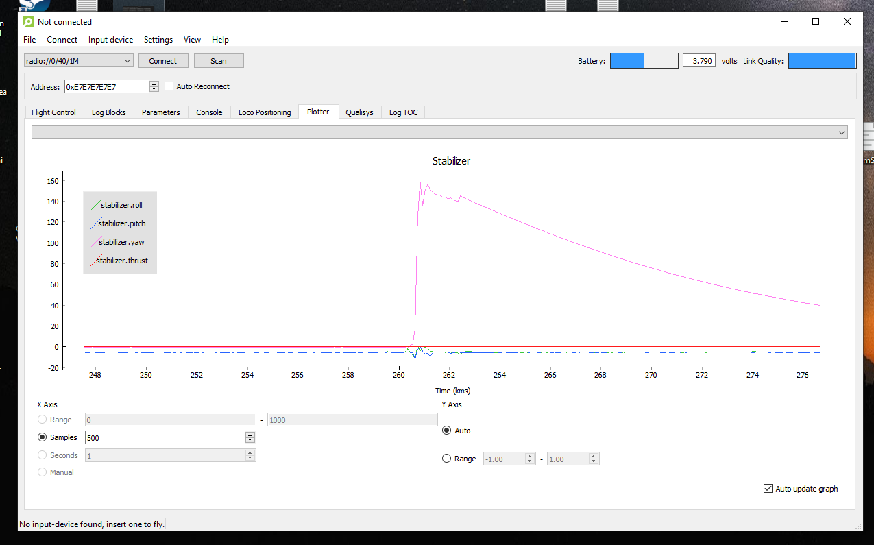

The YAW value stabilizer graph from the Crazyflie client for some reason increases/decreases after turning the drone manually. I thought this was strange because once I rotate the drone for around 90 degrees, the graph will go to 90 degrees but it will slowly go down to 0. This is apparent in whatever drone I use. I've uploaded three images of the graph I took from two different drones. Additionally, if I take a look at the "Flight Control" tab from the client, I can see that the drone's stabilizer is moving around when nothing is actually moving it.

The yaw value increases and decreases is mostly just due to drift. The IMU has a gyroscope which directly measures the attitude rate and not the attitude in an absolute manner. On the ground the attitude values tend to drift quite a bit indeed but once in the air it's much better. The estimators is just more equipped for a 'flying vehicle' then one on the ground. But at one point we have to look at it... it can be a bit annoying indeed to interpret it.
In your case, you don't have to worry about it that much. Just have the crazyflie face in the +x and have a go at flying with it! Try with one first though

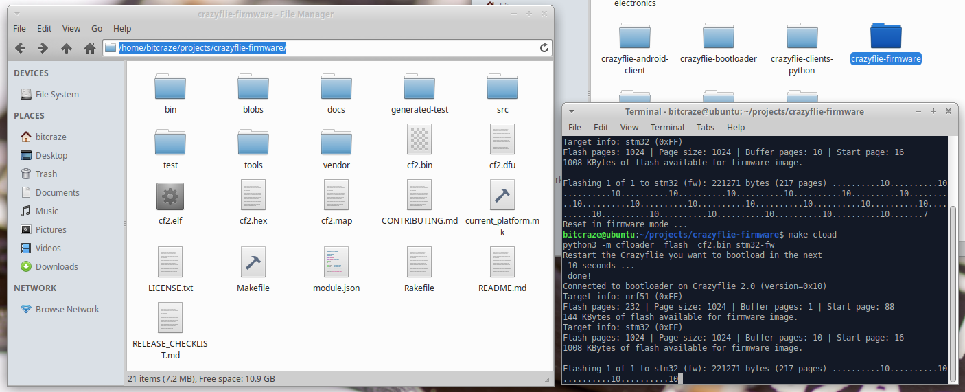

I've attached an image here the process of flashing to the crazyflie to make sure I'm not doing anything wrong.
I've right clicked the /crazyflie-firmware, ran a terminal from that folder and ran the code
I hope I did everything is correct!

It seems to have done the trick indeed
