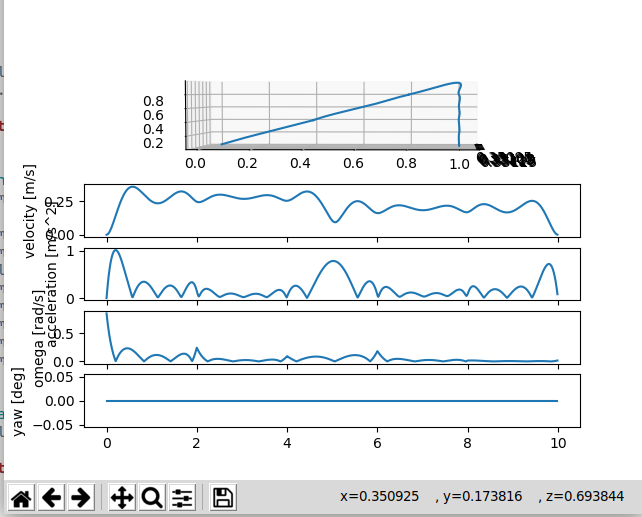

I managed to generate my trajectory using uav_trajectories this is my trajectory: I run my trajectory using autonomous_sequence_high_level.py.
the problem I have is that the drone goes up with a height of 1 meter before executing my trajectory. and also I do not have a good precision. here is my video which shows my trajectory and also the problem of precision that I have.

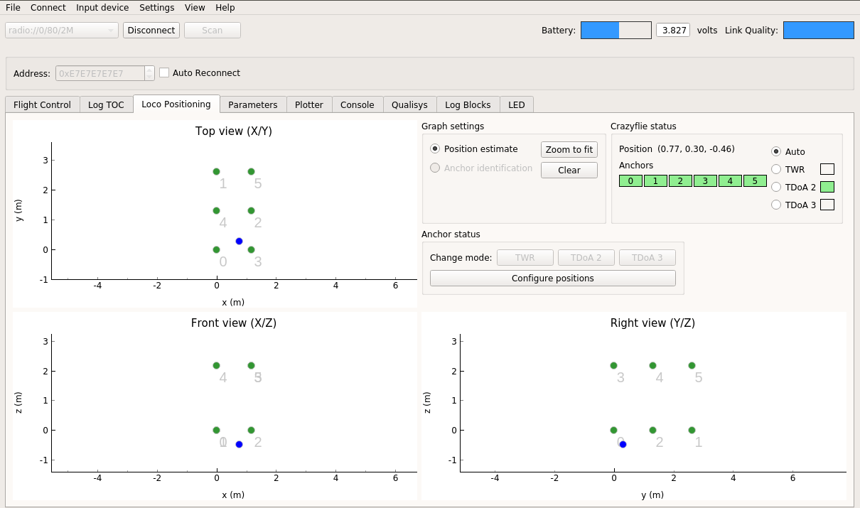

before launching my script I changed the mode to TDoa here is a screen of my cfclient as you see I have a problem of calculation for the z axis.
I want to know where my problem comes from knowing that I have installed my LPS and I have configured my crazyfie with the latest version of firmware.

So what I can see is that the location of the nodes in the LPS tab, do not match the locations of the LPS nodes that I see in your video. Are you sure you went through every step of the tutorial when setting it up, in particular the Anchor position configuration part?

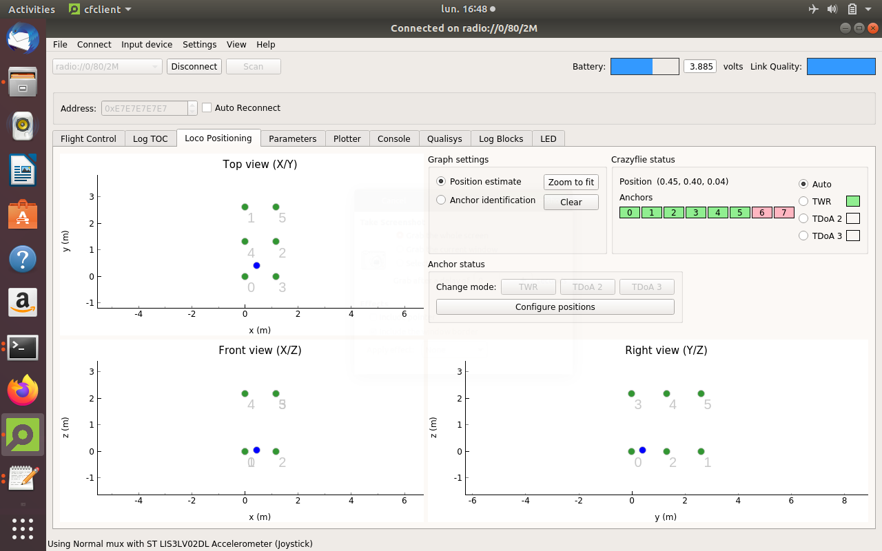

Yes i have tried flying in TWR mode but I had the same problem.
here is a video shows the flies in mode TWR: https://www.youtube.com/watch?v=eOCZovuVl8M
and here is a screen of my cfclient as you see I have a good position measurement:
For the anchors I only have 6 anchors as you said 6 anchors works only with the mode TWR.

I've analyzed both videos together. In general I do not think that there is anything wrong with your setup or how the crazyflie is flying. The way it is flying is to be expected from the LPS system (10-20 cm accuracy). So what it could be is that in the trajectory generation there is a 1 meter offset somehow. we do not maintain uav_trajectory ourselves so it is difficult for us to access what is going wrong there, and also the polynomial is a bit hard to read.
