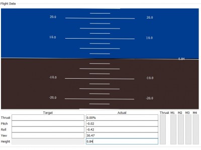

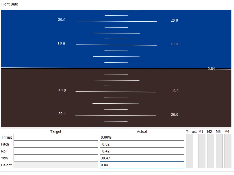

Have you checked what the estimated Z is when the Crazyflie is on the ground? The easiest way is look at the "Height" box at the bottom of the "Flight control" tab in the client. If there is an offset in estimated Z, the controller might aim for the "wrong" height.

thanks for the reply. The height box says 0.85 when it is placed on the ground which doesn't seem right?
I'm not sure how to change this though?

So right now the drone already thinks it is at 84 cm and won't go to the height setpoints given by the script, since it either thinks it is 'in the floor'

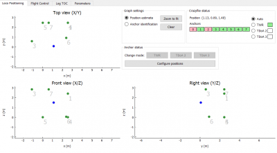

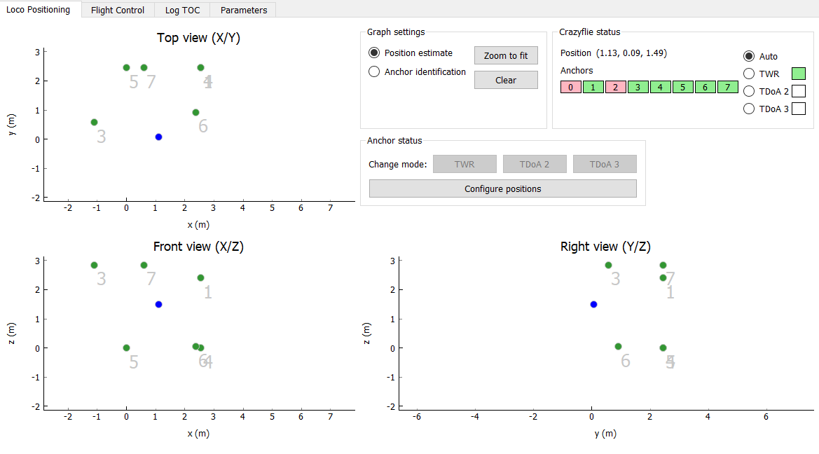

Could you also send us a printscreen of your LPS tab of the cfclient?

thanks for the reply this is a screenshot of the lps tab
And yes it is probable that my setup is not ideal but it is fairly close to what is specified in the documentation. In the lps tab the position seems to be correct? It's strange that the flight control height is different?

So from the first sight, the anchors are not exactly located as specified here: https://www.bitcraze.io/getting-started ... n-the-room. (6 anchors). In the example, it goes from id 0 to 5 and in yours number 0 and 2 are missing. Do you only have 6 anchors or do you have 8 ? Also they do not seem to be placed at exactly the same positions.
Have you also manually entered their real positions in the anchor position configuration ? (https://www.bitcraze.io/getting-started ... to-anchors). Beware that you do have to measure this yourself, since your configuration is different than ours.
