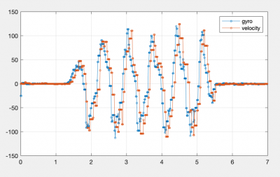

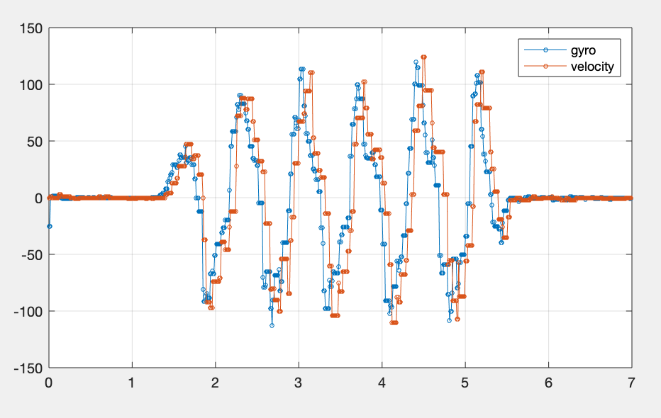

Here's an example comparing the gyroscope and velocity sensor:
I am rotating the board back and forth, I would expect the angular velocity and the velocity read by the sensor to be aligned, but as you can see the velocity sensor is ever so slightly lagging behind the gyroscope which culminates in very poor compensation for angular rotation. When I delay the gyroscope (and distance) measurements by give or take 100 milliseconds the compensation works much better and only measures the lateral velocity. I have done these tests with the following modules and have had the exact same, and in some cases even more worse, results:

Ho, so you are not using the flow deck. Are you attaching these modules to a Crazyflie and if so what driver are you using on the Crazyflie to interface them?
Very interesting measurement nonetheless. This looks like something that we should account for in our EFK implementation.

No I am not using the flow deck, however the data I collected and plotted is the scaled raw output of the sensors before any fusion or processing, the driver I used to interface with the SPI module is the Bitcraze one:
https://github.com/bitcraze/Bitcraze_PMW3901
The results should be repeatable using any board with the PWM3901 sensor; it seems like it's the sensor itself that has this issue rather than a particular board. I was surprised to see the same (or worse) delay with the SPI module when compared to UART; it would be great if someone else could replicate and confirm these results.
